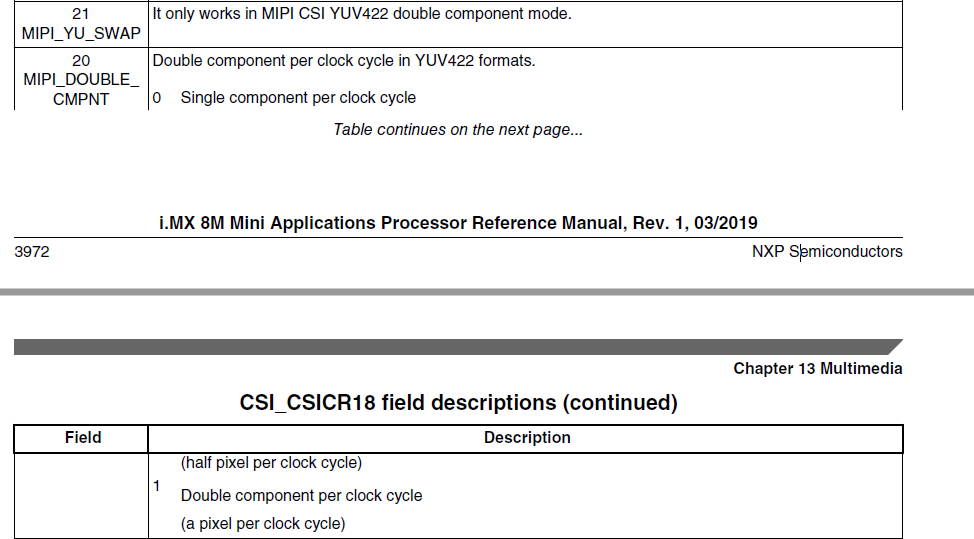

MIPI Camera Frame corruption in IMX8MM when MIPI_DOUBLE_CMPNT and MIPI_YU_SWAP is enabled in CSI_CSICR18
17,331 Views
ashwanthselvam
MIPI Camera frame corruption occurs in IMX8MM when MIPI_DOUBLE_CMPNT and MIPI_YU_SWAP is enabled in CSI_CSICR18 (CSI Control Register 18).
The same works in IMX8M.
I know that the MIPI CSI drivers are different for IMX8M and IMX8MM. Is there something that has to be done in addition, in MIPI CSI driver of IMX8MM to mimic the same behaviour as IMX8M? gogoer

ashwanthselvam
I am testing with a 4 lane AR1335 MIPI Camera. The data format of the sensor is UYVY. Since the waylandsink of Gstreamer supports YUYV, I need to swap the bits to avoid using a videoconverter. Since using a videoconverter means a drop in framerate.  By enabling the MIPI_DOUBLE_CMPNT and MIPI_YU_SWAP, I was able to stream using wayland sink in IMX8M, but when I tried the same in IMX8MM, frame corruption happens.

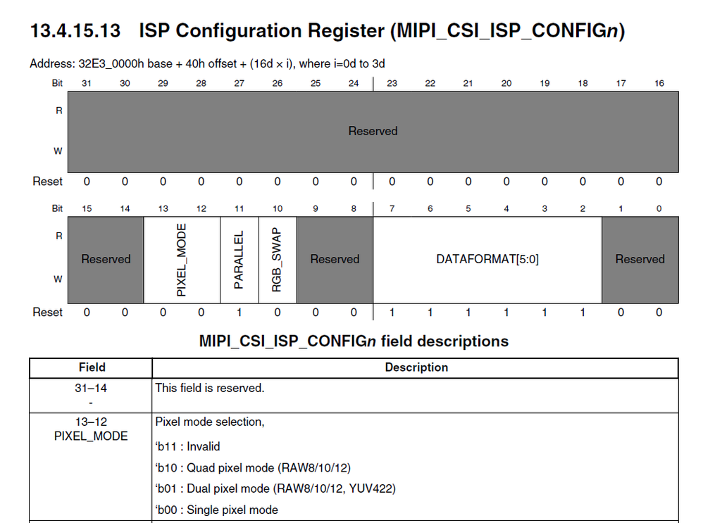

On enabling MIPI_CSIS_ISPCFG_DOUBLE_CMPNT (1 << 12) as per your patch, base address switching Change Err occurs. (BIT_ADDR_CH_ERR_INT)
16,638 Views
haidong_zheng
MIPI_CSIS_ISPCFG_DOUBLE_CMPNT (1 << 12) ?
My patch is not enable this bit. This patch set pixel mode as 01.
16,640 Views

1: confirm camera sensor output double component data:
2: confirm CR18 BIT20/BIT21 MIPI_YU_SWAP/MIPI_DOUBLE_CMPNT be set
3: confirm bit 12/13 of MIPI_CSI_ISP_CONFIG0 PIXEL_MODE is 1
4: Try set /clear CR18 BIT4/BIT5 BASEADDR_SWITCH_EN & BASEADDR_SWITCH_SEL
16,644 Views
ashwanthselvam
Tried your suggestion but no luck. The issue still exists.
