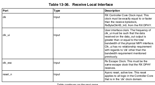

simon6
At the very least is there some information that can help me with the questions asked in: Camera porting guide for MIPI-CSI2 on i.MX8M?  about the clock rates?  Because I found this in the iMX8M docs: pastedImage_2.png
But this does not state anything about relationships or limits of the clocks to each other. How do I know my clock configuration is valid?

igorpadykov
Hi Simon
unfortunately such documentation is not available, sorry.
May be useful to look at linux mipi csi drivers descriptions in
Linux 4.19.35_1.1.0 Documentation
[v9,2/2] phy: Add driver for mixel mipi dphy found on NXP's i.MX8 SoCs - Patchwork
igor
