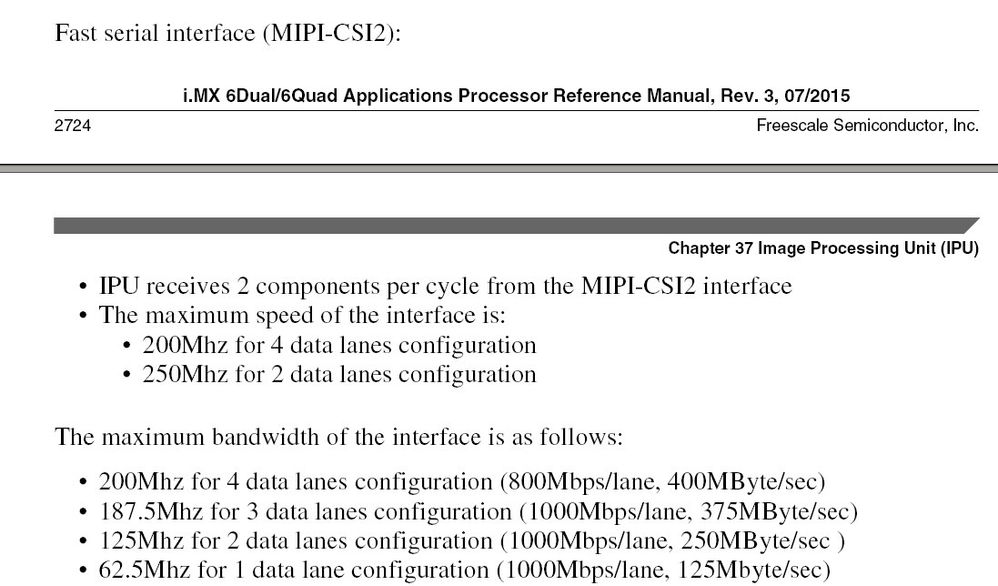

I want to know that the i.MX6D can be received 3MP at 60fps with MIPI-CSI2.
In connection with the above, I have question about how to calculate MIPI-CSI2 required operating frequency.
The maximum bandwidth in MIPI-CSI2 4lane is 3,200Mbps (= 800Mbps/lane x 4lane).
Addition for this, there are following examples in RM(Rev3.0).
To be calculated from the example, I think it is overflowed.
The calculation result is below.
6Mpixel x 24bit x 15fps x 1.5cycles/pixel = 3,24Mbps
Does my calculation is wrong ?
Please tell me how to calculate.
Also please tell me how to calculate the required operating frequency.

you are right: for MIPI-CSI2 generic data needs two cycles, so
it will be 405MB/s and bandwidth is insufficient.
igor

assuming 125 MByte/s per lane, with configuration:
6Mpixel x 24bit x 15fps x 1.5cycles/pixel = 270MB/s * 1.5= 405MB/s
bandwidth will be insufficient.
igor

For 4 lane configuration, the maximum bandwidth is 400MB/s.
So i.MX6D can't support the settings (6Mpixel x 24bit x 15fps x 1.5cycles/pixel ).
Is it correct ?
The example is wrong, isn't it ?
Once again I say, I want to know that the i.MX6D can be received 3MP at 60fps with MIPI-CSI2.
And there data format is RAW Bayer 12bit.
From above, I need following bandwidth.
Is it correct ?
3Mpixel x 12bit x 60fps x 1 cycles/pixel = 270MB/s x 1 = 270MB/s
As a result, can i.MX6D support the spec ?

yes for 1 cycles/pixel calculation bandwidth is correct :
it can be supported with 3,4 lanes configuration.

According to your answer of another thread, generic data needs two cycles in MIPI-CSI2 interface.
https://community.freescale.com/thread/373387
As a result, the required data volume is below when I use generic data with MIPI-CSI2 interface.
Is it correct ?
3Mpixel x 12bit x 60fps x 2 cycles/pixel = 270MB/s x 2 = 540MB/s
If above calculation is correct, since the bandwidth is insufficient, i.MX6D can't support my customer's requirement.
Is it correct ?
