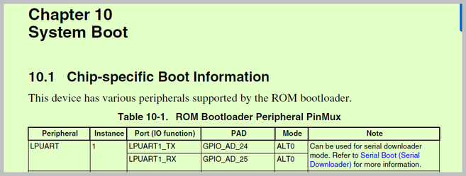

Hello,which UART ports are used for debugging i.MX RT1170

Hi @EMertCakir
I hope you are doing well.
I understand as debug pins , the default pins that our MCUXpresso SDK examples use to output PRINTF() messages. If I did not understood well, please, let me know.
Those pins are GPIO_AD_24 and  GPIO_AD_25. For more details refer to the Reference manual or schematic of our RT1170-EVK. Below an snapshot from the RM.
