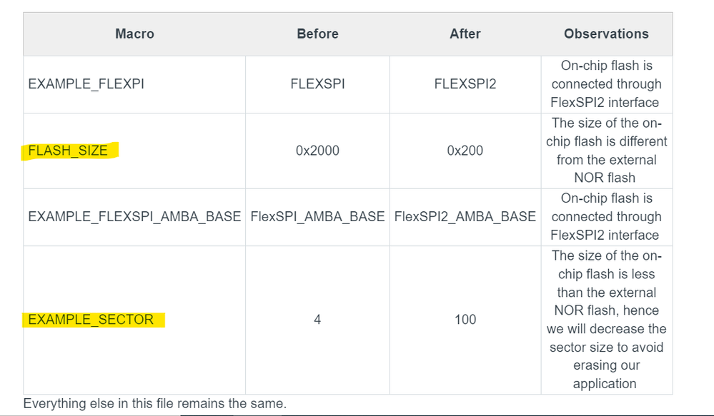

hi i want store some kmph data to the internal flash of the mimxrt1064 i gone through the nxp community i got to know that we can use evkmimxrt1064_flexspi_nor_polling_transfer example to understand so while going through that
link 1:
https://community.nxp.com/t5/i-MX-RT-Knowledge-Base/How-to-use-the-RT1064-on-chip-flash-as-NVM/ta-p/...
==> the example is used flexspi1 i.e external flash so internal flash is connected flexspi2
==> the ROM bootloader will configure the pins of this FlexSPI interface  So flexspi configuration is it required or not
                   ==> where can i get Flash size and example sector means
==> i didnt get what is meant by  customLUT? and also i didnt get meaning of these two lines
  1. Erase sector command of the on-chip flash is 0x20 instead of 0xD7.
  2. Exchange the FLEXSPI command index for NOR_CMD_LUT_SEQ_IDX_READ_FAST_QUAD and NOR_CMD_LUT_SEQ_IDX_READ_NORMAL to align with XIP settings.
i gone at the last provided link i didnt get api reference manal to understan what it is actually api mean and its argumentsf ew api iam mentionning
1) status = flexspi_nor_get_vendor_id(EXAMPLE_FLEXSPI, &vendorID);
2)  status = flexspi_nor_enable_quad_mode(EXAMPLE_FLEXSPI);
3) status = flexspi_nor_flash_erase_sector(EXAMPLE_FLEXSPI, EXAMPLE_SECTOR * SECTOR_SIZE);
4)  status =
flexspi_nor_flash_page_program(EXAMPLE_FLEXSPI, EXAMPLE_SECTOR * SECTOR_SIZE, (void *)s_nor_program_buffer);

hi community update to my my quetion i had done modification by referring below links i compiled and its working but i didnt find ANY API TO READ THE DATA FROM FLASH if i get that api i can verify the data which have writeen
1) iam sharing my code below if any correction required please let me
2)where can i found the api reference manual for above mentioned functions
https://community.nxp.com/t5/i-MX-RT/RT1050-QSPI-flash-change-to-Winbond-W25Q32JV-3-3V/m-p/904534
https://community.nxp.com/t5/MCUXpresso-General/I-can-not-erase-QSPI-Flash-W25Q32JV/m-p/884895
after modification my code is below iam attaching my project please go through it and also iam attaching my file

kerryzhou
Hi @sandeepc ,
  You make things complicate, and refer to the wrong code for the internal flash.
  Please refer to this code:
SDK_2_13_0_EVK-MIMXRT1064\boards\evkmimxrt1064\driver_examples\flexspi\nor_internal\polling_transfer
  You can operate the internal flash directly, the internal flash is the winbond flash.
  Please try it again.
  If you can't find this project, please download the new SDK:
https://mcuxpresso.nxp.com/
Wish it helps you!
kerry

sandeepc
