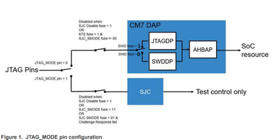

I have a custom board with MIMXRT1042XJM5B. The board has 256 Mbit RAM and 2 x 8 MBit NOR Flash chips, connected to FlexSPI A and FlexSPI B. My intent is to use the two Flash chips in parallel mode.
The problem is that I cannot connect to the boards via JTAG. Here's the output of JLink:

Connecting via SWD works:

The last three lines makeme think there's something wrong with my flash chips.
Where should I be looking at?

Hello
I hope you are well.
To use JTAG it is needed to burn some fuses. This means that if JTAG is accessible you cannot longer use SWD.
Please refer to this figure:
Omar
