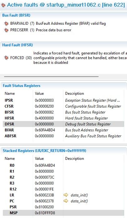

Processor: MIMXRT1062CVL5
External flash memory: W25Q512JV
We are creating a project that uses the LVGL library to display a GUI on a monitor, so we need an external flash memory to store this big quantity of data.
In particular, we use a 64MB Winbond flash memory interfaced with the microcontroller.
The system was working well until the project started to increase in size. In particular when I flash the microcontroller with the debugger it shows me a Hard fault error. It stops the execution at the startup, so it isn't a code issue.
We suspect that it has been generated by the memory configuration, so I attach also the Memory details:
TypeNameAliasLocationSizeDriver
FlashBOARD_FLASHFlash0x600000000x4000000MIMXRT1060_SFDP_QSPI.cfx
RAMBOARD_DRAMRAM0x800000000x1e00000
RAMNCACHE_REGIONRAM20x81e000000x200000
RAMSRAM_DTCRAM30x200000000x20000
RAMSRAM_ITCRAM40x00x20000
RAMSRAM_OCRAM50x202000000xc0000
I've only been able to understand that:
  1. If we use only pictures, without any touchscreen management, the final used size of BOARD_FLASH is only 0.85%. The system starts and shows the GUI.
  2. If we enable the touchscreen management functions, which coordinate the various interactions with the GUI, the final used size of BOARD_FLASH is 24.45%. The system crashes as showed previously.
Any help would be apprectiated!

I'm going to update you. Maybe I finally solved the problem, but I'd like to know if this is correct.
1) SOLVE THE PROBLEM OF SIZE GREATER THAN 8MB OF FLASH
Inside the file in xip\evkmimxrt1060_flexspi_nor_config.c there is a struct const variabile named
qspiflash_config where I changed:
.sflashA1Size         = 8u * 1024u * 1024u,
to
.sflashA1Size         = 64u * 1024u * 1024u,
With this edit, I've been able to use a size greater than 8MB. However I discovered a new limit that is 16MB.
So, I wasn't able to write more than 16MB in a 64MB of flash.

With this edit, the QSPI flash loader is able to program the entire memory.
Hence the firmware seems to work, also when using a huge amount of flash memory (e.g. 40 MB).
Do you think it's right?

2 If we enable the touchscreen management functions, which coordinate the various interactions with the GUI, the final used size of BOARD_FLASH is 24.45%. The system crashes as showed previously.
=>Answer: BOARD_FLASH is 24.45%,this should still OK, please try to disable the cache, whether any improvement or not? Do you just use the flash memory, not other RAM? Whether the RAM is overflow or not?

filo96
I made the following changes:
SCB_EnableDCache(); to SCB_DisableDCache();
SCB_EnableICache(); to SCB_DisableICache();
But it stops at the same Program Counter's line as previously mentioned. Hence I think this is not due to caches.

At the moment I don't have an EVK board, so I cannot try to reproduce the error.
I could exclude some parts of code until it crashes, it's what I tried and what I'll continue to try. I'll update you.
EDIT: I noticed that in "board.h" there is
#define BOARD_FLASH_SIZE (0x800000U)
so I changed it to
#define BOARD_FLASH_SIZE (0x4000000U)
but the error persists...
