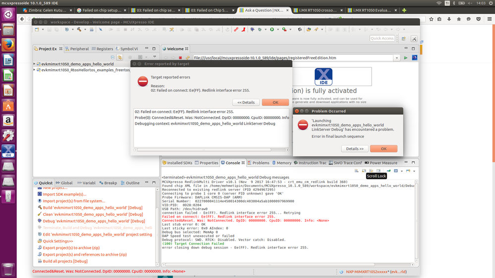

Dear Sir/Madam,
We bought MIMXRT1050-EVK; I downloaded the MCUxpresso, and SDK 2.3.0 for MIMXRT to ubuntu 16.04. Built the cleaned and built the SDK demo_apps_hello world project. I received the following messages.
I would be very grateful, if you help..
1,208 Views
Carlos_Musich
Please update your open sda firmware. Latest is here: OpenSDA Serial and Debug Adapter|NXP
Carlos
