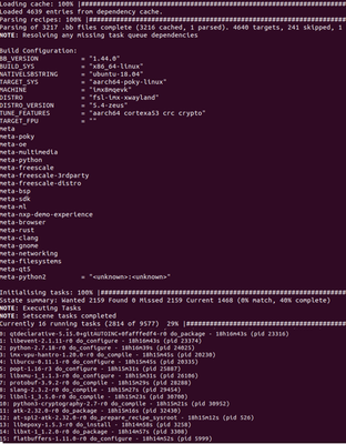

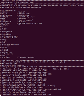

I havd an MCIMX8M-EVKB and I try to compile the kernel and qt5 toolchain following : https://www.nxp.com/docs/en/user-guide/IMX_YOCTO_PROJECT_USERS_GUIDE.pdf
I tried to follow the most standard configuration,
Freezes during build. There are no errors.
1. Full build
repo init -u https://source.codeaurora.org/external/imx/imx-manifest -b imx-linux-zeus -m imx-5.4.70-2.3.0.xml
DISTRO=fsl-imx-xwayland MACHINE=imx8mqevk source imx-setup-release.sh -b build-xwayland
bitbake imx-image-full
2. QT Toolchain
$ DISTRO=fsl-imx-xwayland MACHINE=imx8mqevk source imx-setup-release.sh -b build-meta-toolchain_qt5
$ bitbake meta-toolchain-qt5
Have you ever seen a situation like this?
Even if I search, I can't find the reason.
What is the problem?
Thank you

I have tested and there is no problem in building:
Your build environment has been configured with:
MACHINE=imx8mqevk
SDKMACHINE=i686
EULA=
BSPDIR=
BUILD_DIR=.
meta-freescale directory found
nxf65025:~/imx-yocto-bsp/build-xwayland$ bitbake imx-image-full
NOTE: Your conf/bblayers.conf has been automatically updated.
Parsing recipes: 100% |#############################################################################################################################################################| Time: 0:01:43
Parsing of 3218 .bb files complete (0 cached, 3218 parsed). 4641 targets, 241 skipped, 1 masked, 0 errors.
NOTE: Resolving any missing task queue dependencies
Build Configuration:
BB_VERSION = "1.44.0"
BUILD_SYS = "x86_64-linux"
NATIVELSBSTRING = "ubuntu-18.04"
TARGET_SYS = "aarch64-poky-linux"
MACHINE = "imx8mqevk"
DISTRO = "fsl-imx-xwayland"
DISTRO_VERSION = "5.4-zeus"
TUNE_FEATURES = "aarch64 cortexa53 crc crypto"
TARGET_FPU = ""
