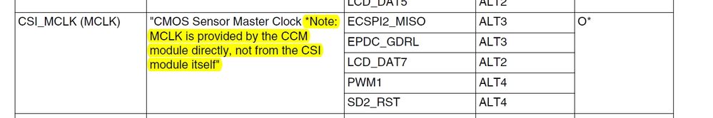

Currently working with SoloLite EVK, I have few doubts on using the camera interface. The camera DOVDD is 1.8V.
All the signals coming to the "Camera Expansion Connector - J24" are EPDC signals, so if not using EPD, can we enable the LVE field (1.8V mode) for the camera related signals, including the EPDC_GDRL (CSI_MCLK)?
Or do we need to provide 3.15V to 1.8V level translators in an add-on board ?
Thanks.

pankajrana
Hi igorpadykov ,
1. Since MCLK is provided by the CCM module directly, is it still possible to it in LVE mode ?
2. If it is possible to use configure LVE feature for Camera signals then we can directly wire up the Camera lines. Please confirm.
Pankaj Rana
1,847 Views
igorpadykov
1. this depends on pad (which is used for such purpose), if it has LVE setting,
then it is possible
2. yes
