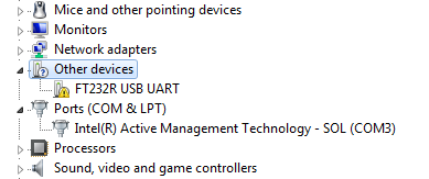

Hi communities,
I set the SW6 to 00001100 and connect usb cables to J505 J509.
I'm using Windows 7 which does not have a Hyper terminal.
In addiction, the board is not able to be detected as a COM port.
anyone can help? I'm really new to this development board.
Thanks a lot!

  Please look at my comments below.
1.
The i.MX6 SDP / SDB design does not support the Serial Downloader mode directly.
According to section 4.1 (How to Enter Serial Download Mode for MFGTool)
of "i.MX_6Dual6Quad_SABRE-SD_Linux_User's_Guide.pdf" :
"No dedicated boot dips are reserved for serial download mode on i.MX 6 SABRE-SD
boards. Therefore, a tricky method is used to enter serial download mode. For example,
set boot mode as SD3 boot (SW6 dip 2, 7 on others are off). Do not insert SD card into
SD3 slot, and power on the board. After "HID- Compliant device" is detected, it means
that the board has entered serial download mode. Insert the SD card into SD3 slot.
Another way to do this is to configure an invalid boot switch setting, for example, set all
the dips of SW6 to off."
2.
For Windows 7 one can use the TeraTerm instead of HyperTerminal.
Also FTDI driver is needed.
http://www.ftdichip.com/
  J505 is used for terminal
J509 – for USB loading.

thank for your reply, Yuri!
I tried install FTDI driver. Now it works.
the download finished with no error. but there is no boot showing up.
May I ask how to check debug info during booting? Can I check the boot log using debugger?
This is another question I post for futher help. wish you could give some suggestions :smileyhappy: thanks a lot

shenglianglu
Hi Yuri,
Thanks a lot for your suggestions.
I was using hyper terminal, which didn't provide debug info during booting. I changed to tera term. It works fine now.
Thanks again for your help
