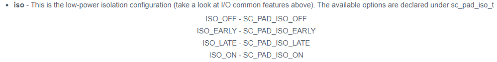

System Controller Firmware 101 - Pad configuration service

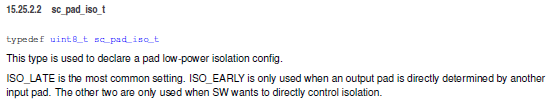

From SCFW porting guide manual (sc_fw_port.pdf)
According to above descriptions, I can chose 4 settings(OFF/EARLY/LATE/ON).
What purpose should these settings be used?
How do these settings work?
