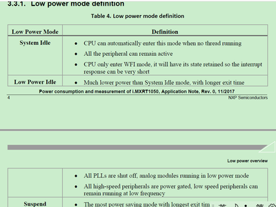

  Your issue should caused by the low power idle,the high-speed peripherials are power gated.

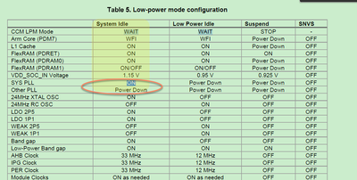

  You want to use the system idle in the following situation, right?
From the clock tree, we can know the LCD clock source:
So, if you want the LCD work, you need to use the system PLL which is PLL2 as the LCD clock source, then you can try it again, it should works.

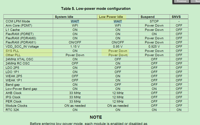

  To the low power idle mode, the PLL situation is like this:
So, the LCD clock source is powered down after you run the __WFI()(in fact, it is the code close the related clock before enter the WFI), which means the low power mode is entered.
In this situation, the LCD can't work anymore as it lacks the clock.
That's why you meet issues.
But, don't worry, after checking with our low-power expert, you still can make it work.
You just need to enable the PLL which is the LCD clock source, please also enable the 24mHZ xtal OSC, that will be more precise.
To make things easy, we suggest you use the system idle code, then just disable the other clock which you don't want, and change the low power mode code to the low power ilde code.
Please try it on your side.
