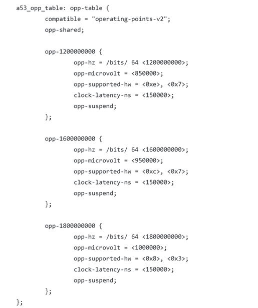

Working with an IMX8m mini and I am looking for power saving operations. I noticed the low power boot mode of the processor. So, I am asking if there is there any way to set the ARM_A53_CLK_ROOT to less than 1Ghz values while linux is running?
What about cores, can they be disabled. Say four cores reduced to 2 cores for different workloads?
3,303件の閲覧回数
danielchen
Hi @A_Guyula :
By default, current BSP support 3 frequencies for imx8mm EVK board.
This is defined in device tree--imx8mm.dtsi
If you need 1Ghz frequency, please add the relative node into the dts file

danielchen
I would suggest you execute command " cpufreq-set -g powersave" to reduce the CPU frequency.  it can be reduced further than 1.2G hz

danielchen
Hi @A_Guyula :

A_Guyula
Ah, my assumption was that these settings were selected by actual requirement, but this seems to lend some kind of arbitrary settings.
This look like a good thing to try then.
