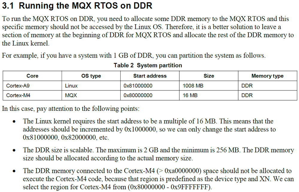

I'm using the Boundary Devices Nitrogen 6SoloX board, which, out of the box loads the M4 into OCRAM (address 0x09000000). Unfortunately, OCRAM is restricted to 128kB and so I looked at loading the M4 binary into DDR (address 0x80000000).
I followed the guide "How to Run the MQX™ RTOS on Various RAM Memories for i.MX 6SoloX":
http://cache.nxp.com/files/microcontrollers/doc/app_note/AN5127.pdf
Configuring u-boot, the kernel, and MQX was fairly straight forward and I completed every step in the process.
MQX
MEMORY
    text        (RX): ORIGIN = 0x80000000, LENGTH = 0x00800000    /* DDR */
    data        (RW): ORIGIN = 0x20000000, LENGTH = 0x00007E00    /* TCMU */
U-Boot
#define PHYS_SDRAM (MMDC0_ARB_BASE_ADDR + SZ_16M) // i.e. 0x81000000
#define PHYS_SDRAM_SIZE (SZ_1G - SZ_16M)
6x_bootscript
I also had to change the "6x_bootscript" that is used to load Linux from u-boot:
a_script=0x81008000
a_zImage=0x81008000
a_fdt=0x83000000
a_ramdisk=0x83800000
a_initrd=0x83a00000
The M4 loads without issue and Linux also loads without any problems. My issue is that at some point during Linux booting, the M4 sometimes hangs, or gives garbled output before hanging.

The M4 seems to hang somewhere around the Freeing unused kernel memory message.
Something is obviously accessing memory where the M4 is in DDR, but how can I troubleshoot this?
I've tried:
/ Finn

CarlosCasillas
Hi Finn,
Have you ensured the DDR boundaries for MQX and Linux in order to avoid memory overlay? These details are mentioned on section 3.1 of the application note that you referred:
Hope this will be useful for you.
Best regards!
/Carlos

gary_bisson
Senior Contributor III
Hi Finn,
The "Freeing unused memory" is displayed when the kernel starts the user-space init process. If you think that is when the error occurs, could you make a test where you removed the init process from your rootfs? This will crash the Linux bootup but it'd be good to see if the M4 is still running at that time, although I don't suspect the user-space to be an issue here.
Otherwise, have you tried a different place of RAM, at the end for instance like we do for the shared memory. Can you try that and update the "linux,usable-memory" accordingly?
linux-imx6/imx6sx-nitrogen6sx-m4.dts at boundary-imx_3.14.28_1.0.0_ga · boundarydevices/linux-imx6 ·...
Hope this helps.
Gary
