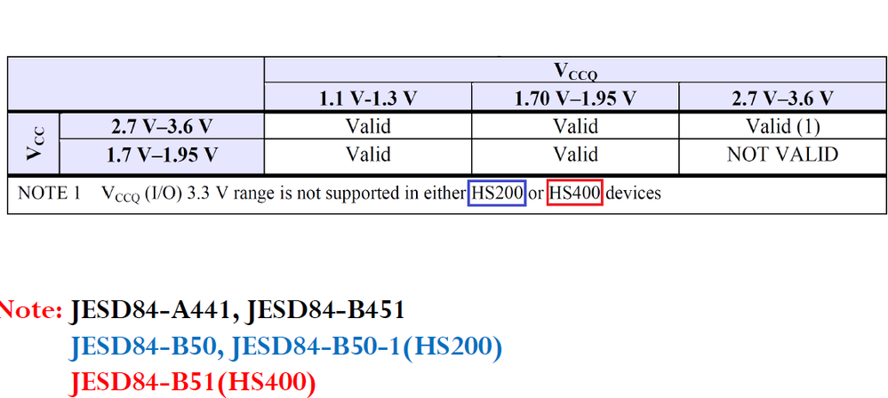

for emmc voltage, if you read the spec, the emmc io 1.8v could work for high speed and legacy speed both. So far, it is not emmc issue.
emmc is not sdcard, sdcard has voltage select when init. and emmc and sdcard belong to different spec.
This is from  emmc jedec spec, emmc io could be 1.8v for all speed.
you can double check the hardware mmc io is 1.8v or 3.3v or add  no-1-8-v to the device tree(linux\Documentation\devicetree\bindings\mmc\mmc.txt) to try.
