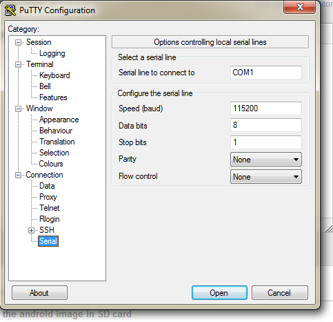

jimmychan
1) yes, it is a 9 pins (male) plug to the QSB board. The other end of the cable (9 holes) connect to the PC.
2,3) Putty is just a Terminal software. You can use any Terminal software on your PC side. The board is connected to your PC via the serial cable. The serial port on your PC mostly is called COM1. So on the Terminal software, just open the connection for the COM1 port. Then you should able to change the uboot setting and see the message on the Terminal screen when the board is booting up. Some setting for the COM1 port (baudrate=115200, 8N1,  Flow Control = None)

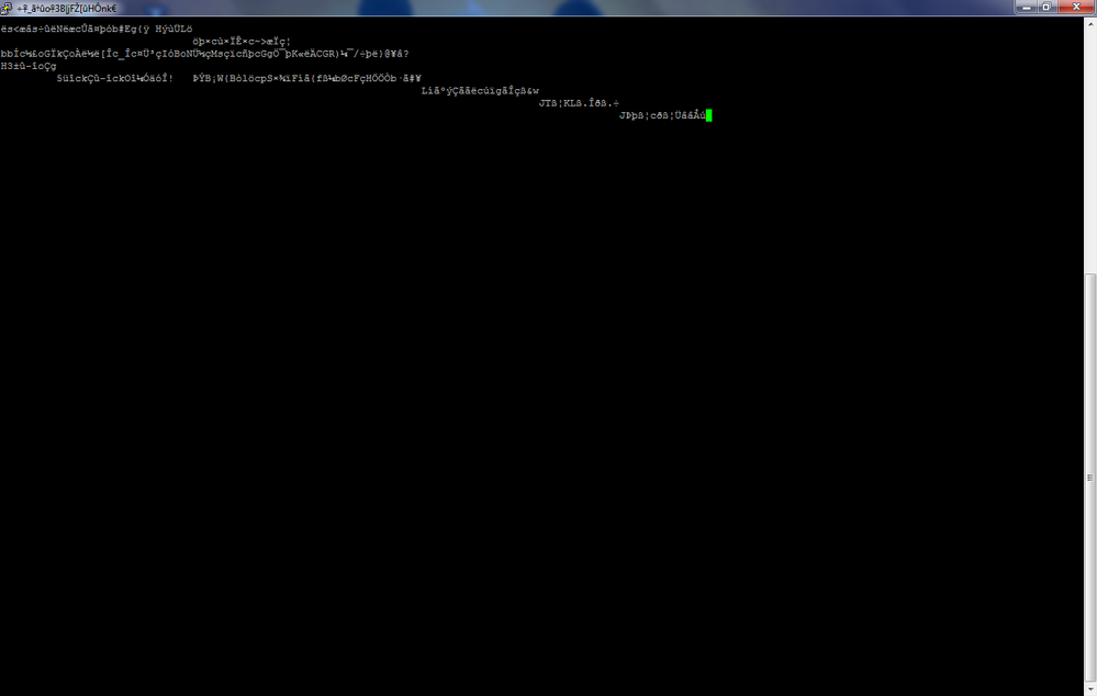

arunmitteam
I tried to see the console output and I found all special characters in the putty screen. Attached the screenshot.console.png

jimmychan
When you run the Putty, please check the Serial setting like this.
