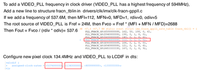

Please refer the content of /arm64/freescale/imx93-9x9-qsb-ontat-wvga-panel.dts, set correct display format  in parallel_disp_fmt.
The most important is about clocks, please refer below steps.

assigned-clock-rates = <537600000>, <134400000>, <400000000>, <133333333>;
