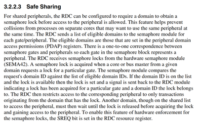

If you want to share ISI between M and A core, you need use SEMA module to access, the SDK contain these API, you may find reference in SDK(boards\evkmimx8mp\driver_examples\rdc).

I also set the ISI's corresponding MDA6 and PDAP32 to m7 (domain1) using RDC module and SEMA module.

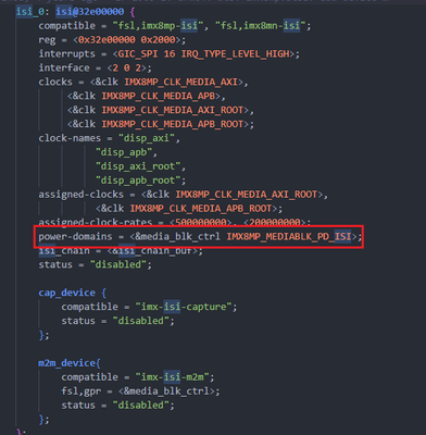

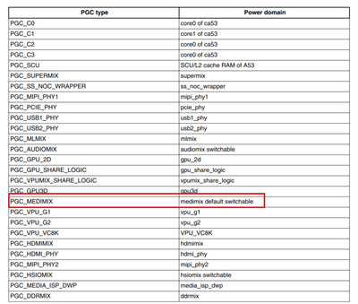

For Linux side, if we want to use ISI, we need power up ISI in media blk domain, and this step needs us to power up the media block ctl in GPC PGC.
I think you may need power up them in M core. Can you check that?
