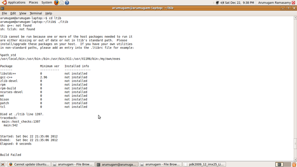

I am using Ubuntu 9.04 and when i un-tar the LTIB source files and try to run the install script, i am facing error message as attached. Need help to successfully install the LTIB for iMX25. Error messages showing a few packages missing.

LTIB requires some package to be installed on your UBUNTU machine.
You can use sudo apt-get install m4 bison patch tcl rpm rpm-build.

arumugamramasam
Hi Saurabh,
Thanks for the information… I am able to install the necessary packages and now LTIB configuration is going on. Thanks once again…
