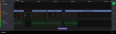

I have connected a logic analyzer and this shows that the final SCL pulse on the ACK bit is missing, so the slave device is continuously driving the ACK bit expecting another clock pulse. Manually pulling the SCL line to GND with a jumper wire releases the SDA line.

I have implemented the SCL line toggle workaround, however I found that this would cause unexpected slave register addresses to be written to. This is because the the transmission doesn't always fail at a byte boundary; sometimes it will fail halfway through a byte as shown in this screenshot, and if the 'i2c rescue' function changes the SCL pin to a GPIO and toggles it to free up the bus, a write to an unexpected address will be completed.
