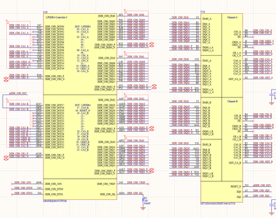

Hi.
We're trying to run the DDR Stress Test on a custom iMX8QM board with LPDDR4.
Using ER14 of DDR Stress Test and V23 of the RPA excel sheet.
We get the following message in the DDR Stress test when downloading.

WARNING! DDR training errors were detected on DDRC 0!
DDR_PHY_PGSR0 = 0x806cc07f
DQS Gate training error detected
Write Leveling training error detected
VREF training error detected
Write DQS2DQ training error detected
Recheck DDR initialization
WARNING! DDR training errors were detected on DDRC 1!
MX8QM: Cortex-A72 is found"
I've checked the connections between iMX8 and LPDDR4 and verified in RPA Excel sheet and it looks correct. I've tried changing the ODT and drive strenghts without any luck.
Schematic is copied from MEK with some minor DQ changes in same bytelane.
We've used the .cfg file from RPA and put that in the SCFW .CFG file for 1.6GHz and also used the script from the RPA excel for the DDR Stress test.
What could be the cause of this?

nxf63675
Hi Viktors94,
The reason for this issue may be wrong memory connections or incorrectly configured "BoardDataBusConfig" parameters in the RPA tool.
Looking into the lines DQ lines DDR_CH1_DQ22 it appears declared on the BoardDataBusConfig incorrectly:
So this can be causing the error.
Israel.
