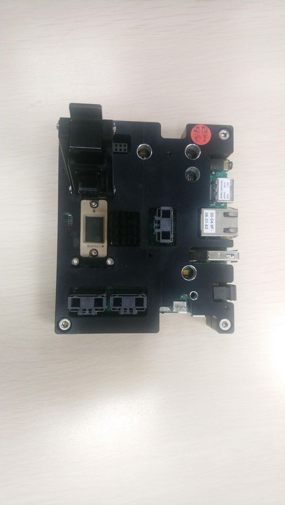

DSC_0050.JPGHi Igor,
We modified the NXP MCIMX8M-EVKB to install a LPDDR4 200B test socket on it. So we can test different LPDDR4 200B parts on it. The Hynix 16Gb part also has the same failure on the MCIMX8M-EVKB as our own board.
I have attached the image of the modified MCIMX8M-EVKB for your reference.
I don't think it is due to board layout issue. Do you have any further suggestions?
