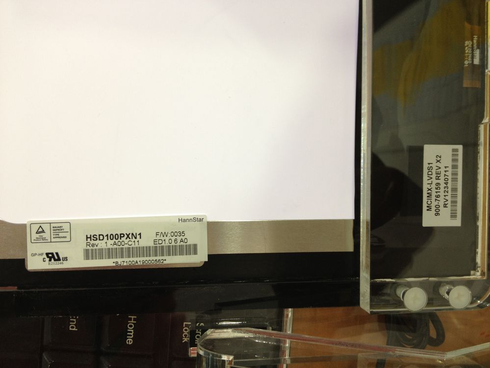

obigose
About Q#1
This image is the back of our touch screen device information.
We think that we use HannStar, not eGalax.
This URL is our main issue reproduction step video.
Touch-screen events are not fired on Ubuntu's X system - YouTube
In the video,
above terminal is "evtest" tool.
below terminal is "xev" tool.
The video shows that "evtest" tool well gets touch-press event when we touch down, unlikely "xev" tool does not.
"xev" test terninal is updated when we touch up with touch-press event.
By these tests - "evtest" and "xev", we suppose that touch-press event is well fired by device driver, but not transferred to Ubuntu's X system.
Question:
Do you know how to fix it??
