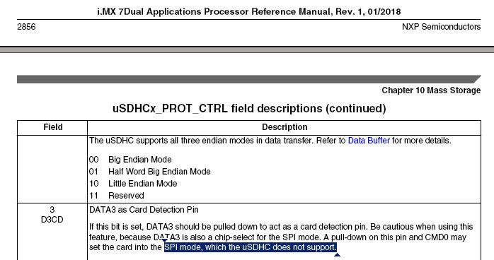

sidebranch
You say SD Card SPI mode (*) is not possible on i.MX7.
Do you mean the uSDHC does not support this, or the ECSPI module does not support this?
As the SD card SPI mode requires just a normal SPI host, the ECSPI should be able to handle it?
So, indeed, like Stefano asked: please explain.
Leon.

igorpadykov
Hi Leon
I believe ECSPI should be able to handle it, one can look at AN2689 document
https://www.nxp.com/docs/en/application-note/AN2689.pdf
igor
