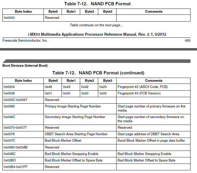

I have following doubhts in FCB format, can you help me to understand.
1. Here Primary and secondary images refers to u-boot and kernel respectively?
2. What is mean by Bad block marker offset?
3. What will happen if Bad block marker swapping is enabled?
4. What is mean by Bad block marker offset to spare byte?

alejandrolozan1
Thanks for sharing your solution. This is very helpful.
Regarding your questions I think I might help with a few of them:
1.- Both images correspond to the boot image, that is ussually u-boot.
2.- The offset in the BCH page where the ROM code swaps the first byte metadata.
3.- The BootRom code will swap BadBlockMarkerByt with metadata[0]
Alejandro

kravik
Thanks for the reply.
If both images refers to U-boot then u-boot will store at two locations in NAND?
I started learning NAND basics with this issue, can you please tell me what is mean  by BCH page? What metadata contains?
