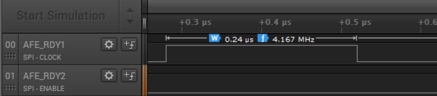

I'm using iMX6ULL custom board. In my application, I read data from two AFE4490 and iMX6 reads data registers after the ADC_READY interrupt(pulse width 0.24us). I configured ADC_READY pins as gpio-keys. In ISR, it generates a uevent as below

iMX6 generates interrupts on ADC_READY signal.
1. But i'm not getting any events at userspace. What's the issue in the configuration?
2. After 30 minutes, kernel panic occurs due to out of Memory issue. How to clear uevent buffer?
