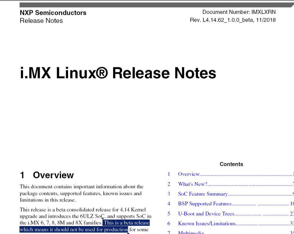

We are trying to bring-up PCIe as Root-Complex only on imx8qxp chip. We are using Kernel version linux-imx-4.14.62
The issue we are facing now, is that the Kernel freezes while probing the pci-imx6 driver. After debugging, we found that it does not come back from any call to readl() or writel() function from the context of probe() function while trying to read any register from the configuration space of the host controller.
Can you point out what should we suspect? What could be the reason for this freeze?

Hi Mahmoud
reason may be hardware or software, for hardware one can check
clocks and power supplies using Hardware Guide PCIE recommendations
and PCIe example schematic in
i.MX 8QXP Design Files for the i.MX 8QXP MEK
https://www.nxp.com/downloads/en/software/i.MX8QXPDF.zip
For software one can look at dts file:
linux/arch/arm64/boot/dts/freescale/fsl-imx8qxp-mek.dtsi
fsl-imx8qxp-mek.dtsi\freescale\dts\boot\arm64\arch - linux-imx - i.MX Linux kernel
Description of PCIe driver in Linux Manual: Linux L4.14.98_2.0.0 Documentation
Recommended to use latest linux and scfw with all patches from
i.MX Software | NXP
Note "linux-imx-4.14.62" was provided as "beta" quality and may not work properly on i.MX8QXP.
igor
