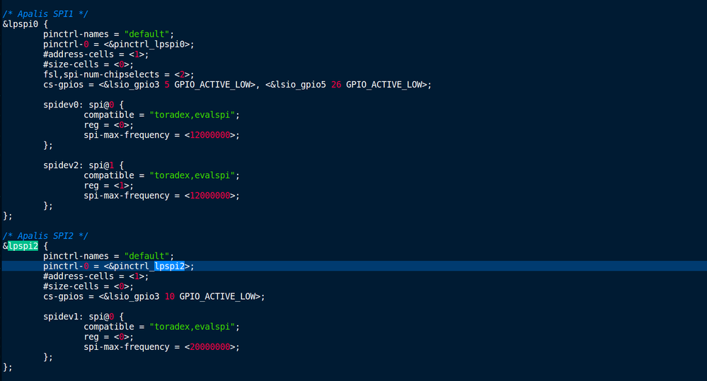

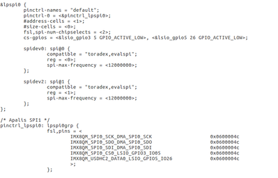

1.SPI DTS Node:
Here is the SPI DTS node we are currently using:
//imx8qm-apalis-v1.1.dtsi
/* Apalis SPI1 */
&lpspi0 {
pinctrl-names = "default";
pinctrl-0 = <&pinctrl_lpspi0>;
#address-cells = <1>;
#size-cells = <0>;
fsl,spi-num-chipselects = <2>;
cs-gpios = <&lsio_gpio3 5 GPIO_ACTIVE_LOW>, <&lsio_gpio5 26 GPIO_ACTIVE_LOW>;
spidev0: spi@0 {
compatible = "toradex,evalspi";
reg = <0>;
spi-max-frequency = <12000000>;
spidev2: spi@1 {
reg = <1>;
/* Apalis SPI2 */
&lpspi2 {
pinctrl-0 = <&pinctrl_lpspi2>;
#size-cells = <0>;
cs-gpios = <&lsio_gpio3 10 GPIO_ACTIVE_LOW>;
spidev1: spi@0 {
reg = <0>;
spi-max-frequency = <4000000>;

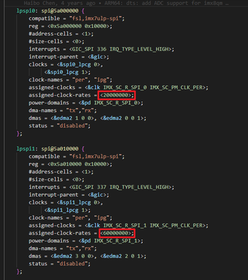

//imx8-ss-dma.dtsi
lpspi0: spi@5a000000 {
compatible = "fsl,imx7ulp-spi";
reg = <0x5a000000 0x10000>;
#size-cells = <0>;
interrupts = <GIC_SPI 216 IRQ_TYPE_LEVEL_HIGH>;
interrupt-parent = <&gic>;
clocks = <&spi0_lpcg 0>,
<&spi0_lpcg 1>;
clock-names = "per", "ipg";
assigned-clocks = <&clk IMX_SC_R_SPI_0 IMX_SC_PM_CLK_PER>;
assigned-clock-rates = <24000000>;
power-domains = <&pd IMX_SC_R_SPI_0>;
dma-names = "tx","rx";
dmas = <&edma2 1 0 0>, <&edma2 0 0 1>;
status = "disabled";
lpspi2: spi@5a020000 {
reg = <0x5a020000 0x10000>;
#size-cells = <0>;
interrupts = <GIC_SPI 218 IRQ_TYPE_LEVEL_HIGH>;
clocks = <&spi2_lpcg 0>,
<&spi2_lpcg 1>;
assigned-clocks = <&clk IMX_SC_R_SPI_2 IMX_SC_PM_CLK_PER>;
assigned-clock-rates = <60000000>;
power-domains = <&pd IMX_SC_R_SPI_2>;
dmas = <&edma2 5 0 0>, <&edma2 4 0 1>;
lpspi3: spi@5a030000 {
reg = <0x5a030000 0x10000>;
#size-cells = <0>;
interrupts = <GIC_SPI 219 IRQ_TYPE_LEVEL_HIGH>;
clocks = <&spi3_lpcg 0>,
<&spi3_lpcg 1>;
assigned-clocks = <&clk IMX_SC_R_SPI_3 IMX_SC_PM_CLK_PER>;
power-domains = <&pd IMX_SC_R_SPI_3>;
dmas = <&edma2 7 0 0>, <&edma2 6 0 1>;
imx8qm-aplis-ixora-v1.1.dtsi
/* Apalis SPI1 */
&lpspi0 {
#size-cells = <0>;
spidev0: spi@0 {
reg = <0>;
spidev2: spi@1 {
reg = <1>;
/* Apalis SPI2 */
&lpspi2 {
#size-cells = <0>;
spidev1: spi@0 {
reg = <0>;

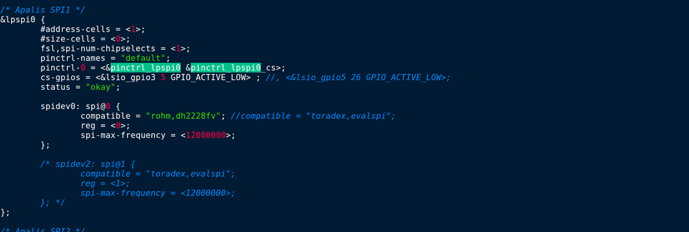

You may need add device node in spi node like this, this is an example from evk dts.
&lpspi2 {
	#size-cells = <0>;
	fsl,spi-num-chipselects = <1>;
	pinctrl-0 = <&pinctrl_lpspi2 &pinctrl_lpspi2_cs>;
	status = "okay";
	spidev0: spi@0 {
		reg = <0>;
		compatible = "rohm,dh2228fv";
		spi-max-frequency = <30000000>;
Add spidev0 or spidev1 and add max7219 compatible name in drivers/spi/spidev.c

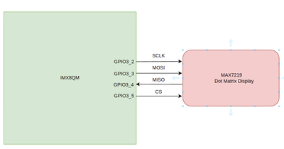

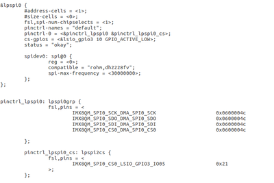

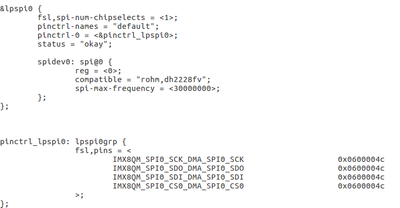

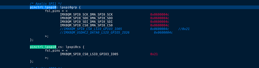

Our connection with the i.MX8QM and Matrix display is illustrated in the diagram below.
Our Modification :
We have done the below modification in the device tree
First Configuration
This configuration was already there in the default source code. But with this device tree modification, the spi is not working ( There is no signal movement on the CLK and CS line )
Second Configuration:
We have taken the reference of this device tree configuration from the imx8qm-mek device tree . But with this device tree modification, the spi is not working ( There is no signal movement on the CLK and CS line )
Third Configuration :
We have taken the reference of this device tree configuration from the mx8qxp-lpddr4-val.dts . But with this device tree modification, the spi is not working ( There is no signal movement on the CLK and CS line )

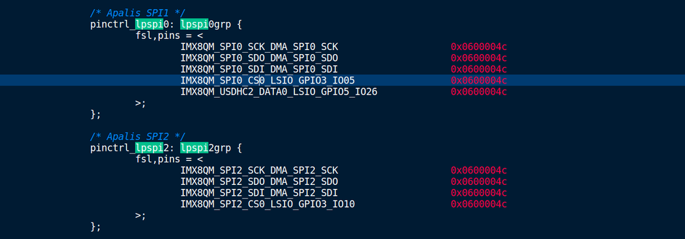

24,186 Views
Zhiming_Liu
Please check if there is othe node using SPI0 node, like on MEK , SAI is using SPI0 PAD.
	pinctrl_sai0: sai0grp {
		fsl,pins = <
			// IMX8QM_SPI0_CS1_AUD_SAI0_TXC              0x0600004c
			IMX8QM_SPI2_CS1_AUD_SAI0_TXFS             0x0600004c
			IMX8QM_SAI1_RXFS_AUD_SAI0_RXD             0x0600004c
			IMX8QM_SAI1_RXC_AUD_SAI0_TXD              0x0600006c
 For device rate, you may need modify default device speed.
These all depend on your board dtsi
