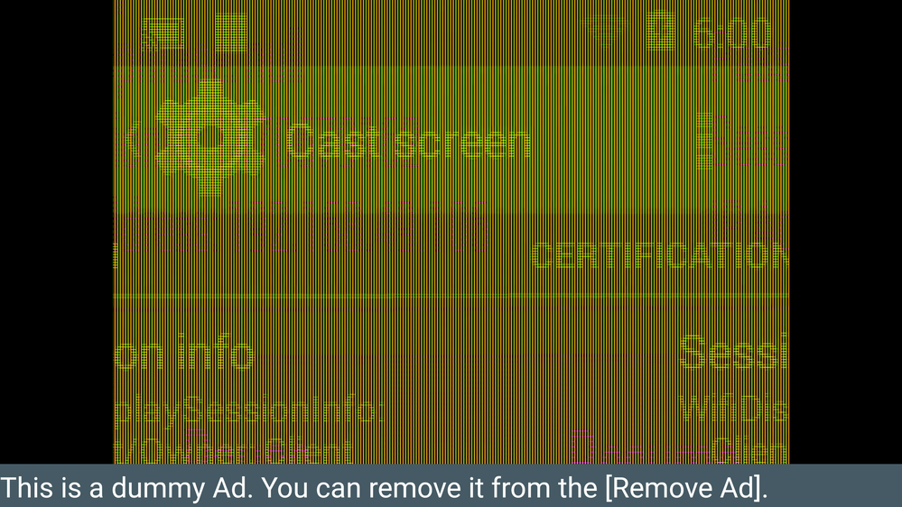

We are facing issue in miracst "source". We are using nitrogen6_max board with wl1837 module over SDIO interface. Android release is boundary-imx-kk4.4.3_2.0.0-ga . We have successfully interfaced WL1837 module. WiFi Direct/P2P functionality is working properly. We are using "WiFi-Display Sink player" android application as miracast "sink" on Samsung galaxy S6. This sink app is working fine with other mobile phones as miracast source.
Please help us to find the issue.
Please find logs and screenshot of distorted result at sink app. Frames changes at sink while changes at source but with distorted effect.
We are getting following error from /myandroid_kk/external/fsl_imx_omx/stagefright/src/OMXFSLPlugin.cpp:
" Not supported color format 4! "
Our Setup: Nitrogen6_max + 1024x768 display + wl1837mod WiFi

For your issue, can you try modifying the device tree so the framebuffer default_bpp is 32-bit instead of 16-bit?

Hi Gary,
We tried as you suggested (default_bpp = 32 ) but we got error while using WFD source like this:
  • "I/OMXPlayer: LEVEL: 1 FUNCTION: OMX_S32 PreProcessIPUInit(VpuEncoderIpuHandle*) LINE: 856 "
  • "I/OMXPlayer: Open /dev/mxc_ipu failed."

That is strange, I don't understand why changing the framebuffer depth would impact the /dev/mxc_ipu node access. Are you sure warning isn't there when default_bpp = 16?
Also, what are the permissions of /dev/mxc_ipu, have you tried changing it?

Hi Gary,
Now Miracast source works good by your suggestions and changing permission like this in ueventd.freescale.rc.:
/dev/mxc_ipu    0660   graphics   system
to
/dev/mxc_ipu    0666   graphics   system
Thanks for support.
