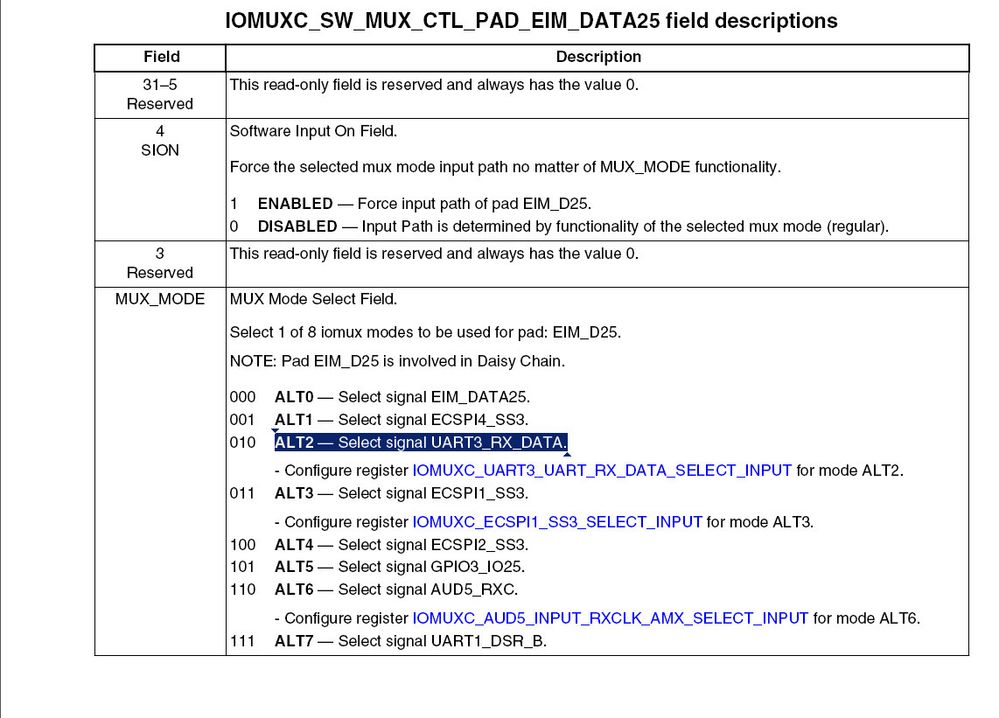

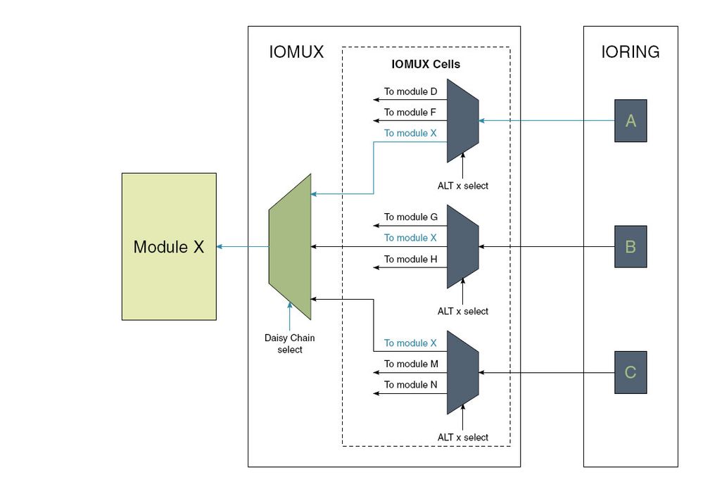

Hi,all
     I want to know how to use the gpio function "daisy chain", and after reading the MX6SL reference manual,I dont know how to use it. Could you give me more info in detail. More samples are better, 3Q!

Hi tony
please look at pictures describing selection i.MX6Q UART3_RX_DATA
for pad EIM_D25, daisy chain is used for input signals
