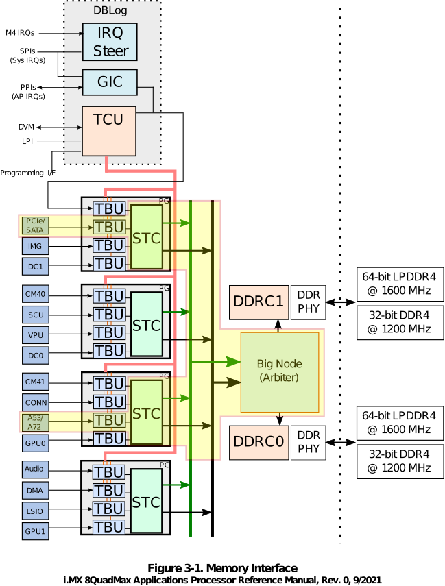

Dear NXP Community,
In the i.MX 8QuadMax Reference Manual (Rev. 0, 9/2021), the section 1.2.1.2 states that "the DRAM Block (DB) is the big switch in the [i.MX 8QM] system. [...] Each subsystem is connected to the DB by a point-to-point SSI (Source Synchronous Interface) link. [...] The System Traffic Controller (STC) is in charge of shaping traffic coming out of a subsystem and updating their QoS".
Is there a way to configure the SSI (especially the STC)?
If not, is there a way to monitor the "Big Node Arbiter" (please see the figure 3-1), for example to detect congestion or any failures?
Thank you in advance.
Nicolas

NicolasVS
Thank you very much Joseph for your fast and concise reply!
Is there further documentation available about this SSI interconnect, perhaps under a non-disclosure agreement?

JosephAtNXP
The department is interested in a more specific subject. Could you clarify in more detail what are you trying to optimize (particular use case, subsystems involved etc.)? Perhaps then the team would be able to provide a more focused guidance.

JosephAtNXP
Thank you for your interest in NXP Semiconductor products,
Please excuse the late reply,
The SSI is a point to point structure – it takes the 5 AXI channels and muxes them onto two transport layers – there is no high level arbitration – simply allows the write data and ra/wa to overlap on the same wires (RA > WA > WDATA)
SCT does mux as told by you; which acts as a distributed arbiter over 4 channels – choosing the 3 highest priority, following a QoS based priority arbiter.
In conclusion, the IP handles congestion based on QoS and there shouldn't be any congestion that the module can not be able to handle.
