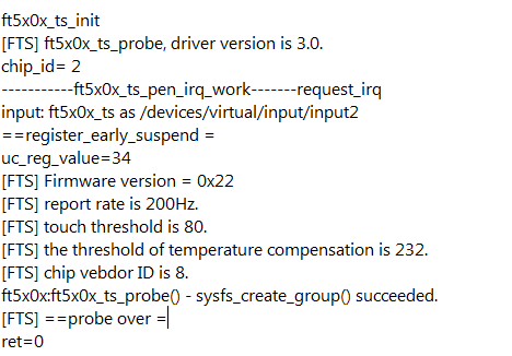

hello,
       recently,I also do some work about FT5X06,but  the screen can't work ,there is no reflect when I touch the screen ,then I checked it ,it seem that  the interrupt  of touch ic has problem  .the some files or message as follows:
pastedImage_0.pngout
can you give me some advice about this? Thank you !
