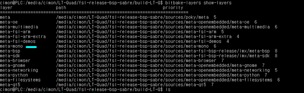

I also wanted to install Mono Framework into i.MX6Quad image .
However, I couldn't even build a image. (There were so many errors)
I did following things,

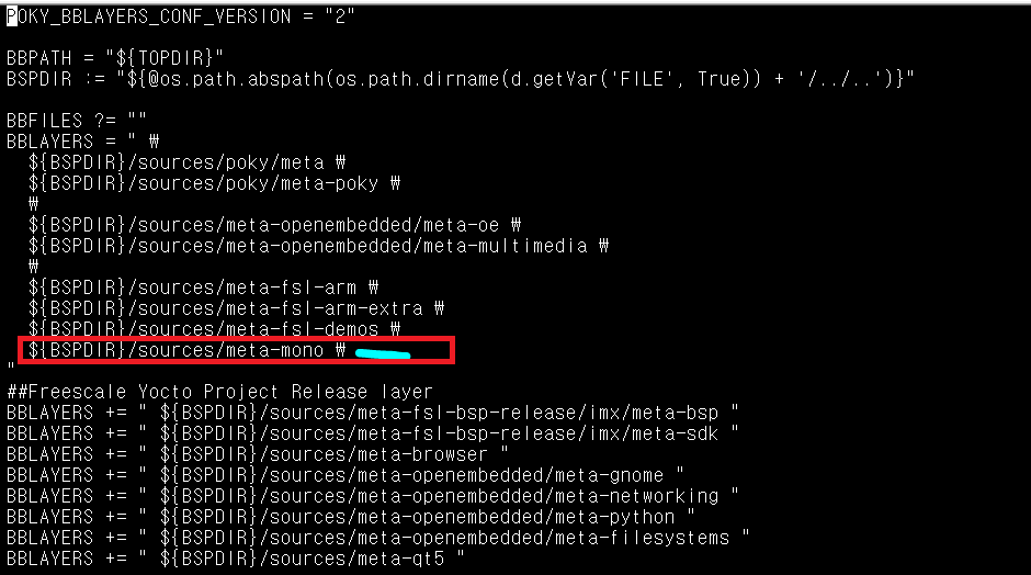

1. Downloaded meta-mono = git clone git://git.yoctoproject.org/meta-mono
2. Added meta-mono to the sources directory
3. Added the meta-mono layer path to conf/bblayers.conf

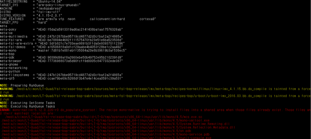

bblayers.conf.png4. When I try to build a image by using command "bitbake core-image-mono" , there were so many errors as below.
Could you give me any advice?

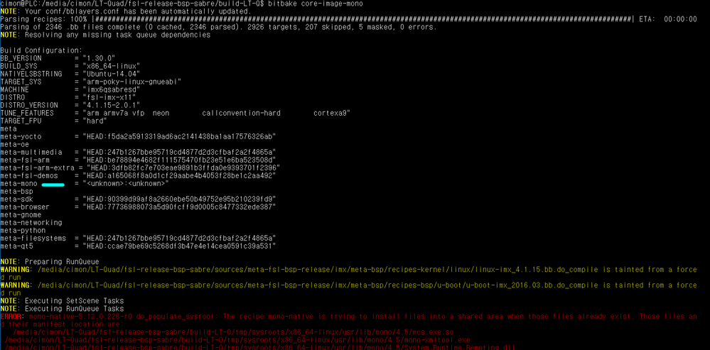

I tried to build an image after following above guides and then I couldn't also build.
There were the same error messages.

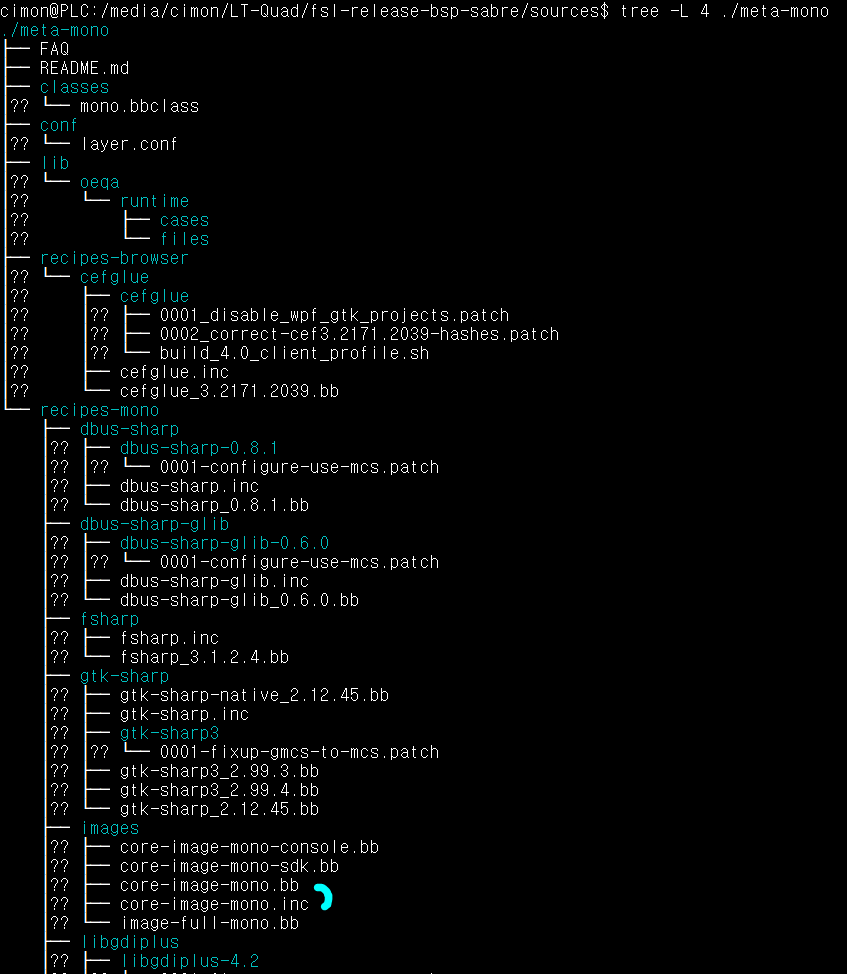

1. Created meta-mono layer.
2. Downloaded meta-mono recipe = git clone git://git.yoctoproject.org/meta-mono
3. Remove all data in the source/meta-mono. (not meta-mono folder)
4. Move downloaded meta-mono data to source/meta-mono
5. Added the meta-mono layer path to conf/bblayers.conf
and then there were the same errror messages.
I think that meta-mono         = "<unknown>:<unknown>" message is very weird.

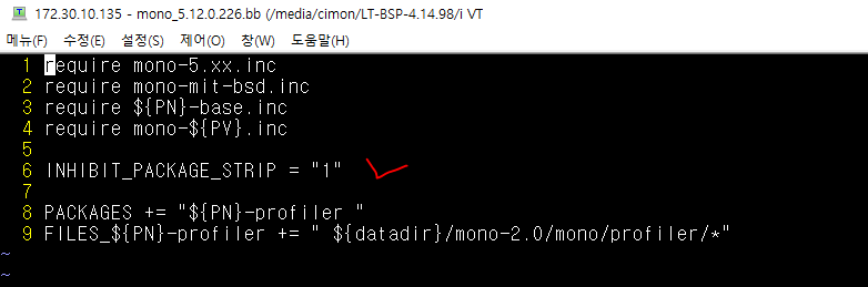

I solved this issue as below.
LT-BSP-4.14.98/imx-yocto-bsp/sources/meta-mono/recipes-mono/mono/mono_5.12.0.226.bb
added
INHIBIT_PACKAGE_STRIP = "1"
