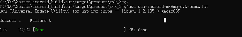

Hi sir
I used the uuu with the lst script to flash the images, it seems ok, as blew:
But it seems can't boot, the error log as blew:
Could you give me the solution ?

Seems like there is a problem with the boot.img, could you please share which Android version you are using?
I assume that you are building your own image, could you please share the procedure you follow to build it?

Thank you very much. Yes,  you are right, it seems the u-boot.img and the boot.img build under the different enviorment, It seems ok when I rebuild all the images under the same enviorment, and download them, it seems ok.
