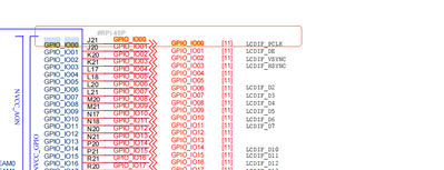

Imx93 debugging IR, the schematic diagram is as follows, support IR? If yes, how to debug?

@xiang_1001 , Please refer imx8mm that has support for IR. Some time back I had tested it and wrote a technical blog - Enabling Infrared Receiver on iMX8MM EVK - NXP Community
The principle remains the same, that a GPIO will be used for an IR receiver. In the blog, I have mentioned the driver and the dtsi to enable it. you can probably start from there and debug.
