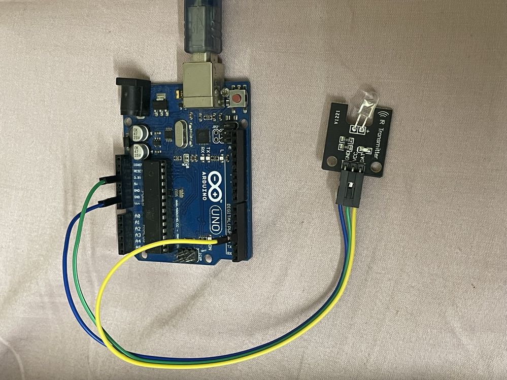

Arduino interfaced with IR TX will send IR messages to iMX8MM interfaced with IR RX LED
Hardware connections:
IR TX Module         <---->          Arduino Uno
GND                          -                     GND
3.3V                          -                     3.3V
DAT                           -                     D3
IR transmitter LED connected to Arduino UnoIR transmitter LED connected to Arduino Uno

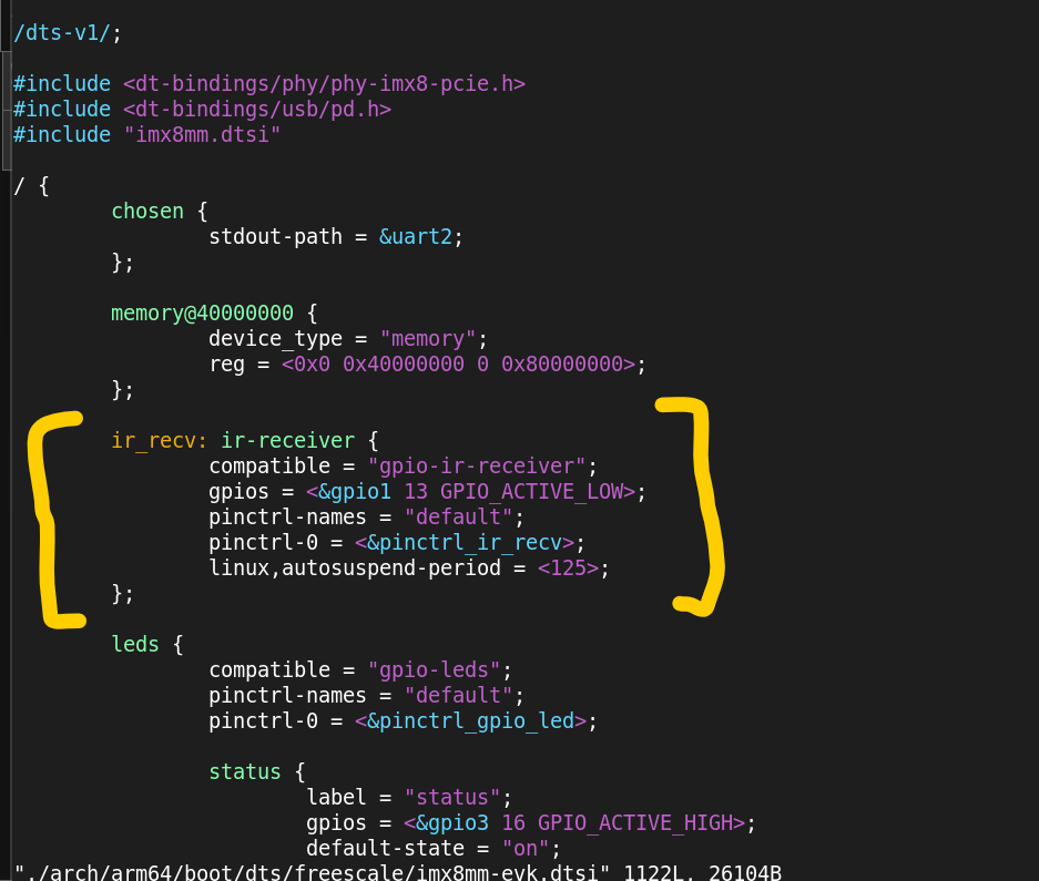

On iM8MM, The IR receiver is connected to GPIO1_13. drivers/media/rc/gpio-ir-recv.c is responsible to configure this GPIO using the dts entry present in  arch/arm64/boot/dts/freescale/imx8mm-evk.dtsi
Device tree changesDevice tree changes
gpio_ir_recv_probe will be called from drivers/media/rc/gpio-ir-recv.c.

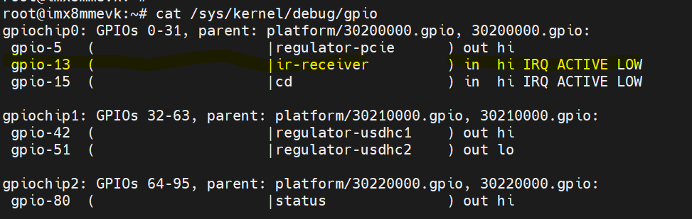

At linux prompt, you can verify the gpio configuration using sysfs:
IR GPIOIR GPIO

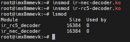

Now insert the NEC and RC5 decoder modules. This gives the kernel ability to be able to decode the   NEC and RC5 IR protocols.
LIRC DecoderLIRC Decoder

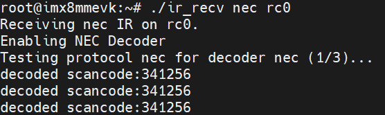

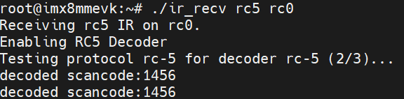

Next, we need a program that utilizes the decoder driver to start decoding the IR signals coming onto the IR Receiver of iMX8MM EVK.
Some example invocations of the user-space binary we have built for the above purpose:
RC5 DecoderRC5 DecoderRC6 DecoderRC6 DecoderNEC DecoderNEC Decoder
ir_recv accepts 2 arguments:-
1st argument - protocol to enable
2nd argument - the remote-control device created in the /sys/class/rc
example - /sys/class/rc/rc0
Note - Not to be confused with the protocols rc5 or rc6. The 2nd argument is not the name of the protocol
ir_recv
utility that we have built will open the /dev/lirc0 device and make an ioctl call LIRC_SET_REC_MODE to set the LIRC driver in Recording mode.
These ioctls are handled in drivers/media/rc/lirc_dev.c in the kernel source code.
So that whenever you run the ir_recv binary, it polls for the IR protocol scan code and prints it if successfully decoded.
