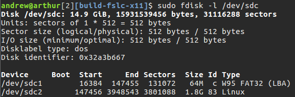

Problem
I need help getting a bootable sdcard for the imx8qmmek. The software from the release site here contains a .sdcard image. If I write that to an sdcard the system boots. What I want to be able to do is build that image. When I try to build an image with the steps outlined in the fsl-community-bsp-platform repo I do not get the .sdcard image as an output.
A solution would be to get the steps to build the sdcard image.
Things I've Tried

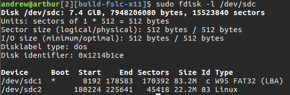

I have tried the .wic file output but it does not boot board. When I inspect the wic file with fdisk it doens't match the .sdcard image in the release. This leads me to believe the wic isn't being created correctly or its not the image I need to create a bootable .sdcard.
.wic image:
.sdcard image:
