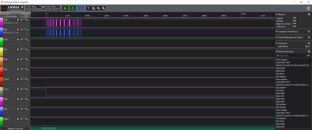

Hello everyone,
I'm currently trying to enable the MIPI-DSI display based on the Imx8mp Variscite board.
Hoping that someone can help me.
I'm using the following setup :
  • Driver : panel-sitronix-st7703.c updated regarding the TFT (based on a ST7703 controller)
  • DST : imx8mp-var-dart-dt8mcustomboard.dts updated
Previously I updated the DTS for another TFT, and then using an other controler HX8394.
Using a MIPI analyzer (LA5076 and oscilloscope) I'm able to check that the driver ; HX8394, was correctly scheduled and the right behavior during the init phase (during the LP mode) :
By switching to the ST7703, I'm not able to catch the init sequence in output (using the same analyzer as previoulsy).
I can see that the driver is correctly called and additing some debugging instruction I can see that the frame are correctly built :
[    0.078755] platform 32e80000.lcd-controller: Fixing up cyclic dependency with 32e60000.mipi_dsi
[    2.147933] imx_sec_dsim_drv 32e60000.mipi_dsi: version number is 0x1060200
[    2.160420] panel-sitronix-st7703 32e60000.mipi_dsi.0: 640x960@99 24bpp dsi 4dl - ready
[    2.170998] imx-drm display-subsystem: bound 32e60000.mipi_dsi (ops imx_sec_dsim_ops)
In addition what the DTS looks like (I kept the HX8394 names, as I previously used the HX8394, I only changed the compatible line) :

joanxie
you can refer to the link as below
https://community.nxp.com/t5/i-MX-Processors/how-to-add-a-new-panel-with-imx8mm-evk-I-got-some-probl...
let me remind, try to add this in your driver dsi->mode_flags |= MIPI_DSI_MODE_LPM;
6,280件の閲覧回数
Tang_
Hello Joanxie,
Thank you very much for your help, by changing the following lines :
static const struct st7703_panel_desc xbd599_desc = {
        .mode = &xbd599_mode,
        .lanes = 4,
        .mode_flags = MIPI_DSI_MODE_VIDEO | MIPI_DSI_MODE_VIDEO_SYNC_PULSE | MIPI_DSI_MODE_LPM,
        .format = MIPI_DSI_FMT_RGB888,
        .init_sequence = xbd599_init_sequence,
Adding the flag MIPI_DSI_MODE_LPM, I'm able now to see the init sequence, below a screenshot from the power-up :
One thing that remains strange : I am not able to see the clock...
Any idea ?

Tang_
To keep you updated
I finaly found where was my issue, the analyzer had a wrong setting and had a too high threshold during the HS mode (lowest value compare to the LP mode)
I can now sample the signals even if I'm not able to detail the frame due to the bandwidth.
I'm able to verify the good behavior during the init sequence and afterward by changing as well the values in the drm_display_mode structure to display something on the screen.
But for now I still have some lines, that you can see here, over the picture :
I guess it's coming from the timing setting as well, maybe the clock (in the drm_display_mode), but even by setting the following value I still have this issue :
clock = (H Total x V Total x 60) / 1000
Am I wrong with the clock value ? Or could it from somewhere else ?
