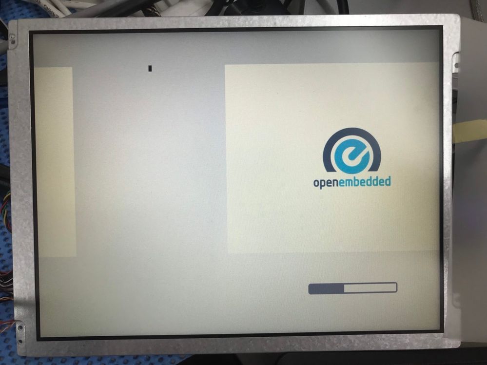

Hi, I have a problem.  I use the sn65dsi8x dirver to enable LVDS signal. I can see the image, but image shift right.
I can modify which parameter to fix this problem ? I have tried the hfront_porch , hback_porch, but the problem is not fix.

I'am working with imx8mm using sn65dsi83 and ihave the same issue, can you please share the solution?

Hi hank
one can look at below variscite guidelines for adding custom panel. also
pay attention to proper panel initialization, function rad_panel_push_cmd_list() in
panel-raydium-rm67191.c\panel\drm\gpu\drivers - linux-imx - i.MX Linux kernel
DART-MX8M Display - Variscite Wiki
