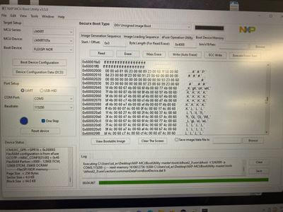

mrecoskie
We have tried using the slightly older NXP-MCUBootUtility.  With the flash settings for the ISSI_IS25LPxxxA it seems to read the flash successfully over the UART and through the serial flash loader.  I imagine this confirms the FlexSPI bus and flash design.  Now how to make this work for our program?
Below are the program defines and qspiflash_config in the MCUxpresso IDE produced software.  A simple 'hello_world' program via UART is used.  When we boot we get no UART output.

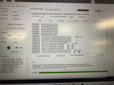

mrecoskie
Different tools like the MCUBootUtility and the Secure Provisioning tool have different abilities to write the FDCB and IVT and Application.
Could someone suggest one image and one method which is known to work with the RT1052 and IS25LP032D flash connected via FlexSPIA?
Or perhaps the memory contents could be spot checked?
11,704件の閲覧回数

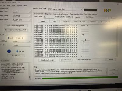

mrecoskie
Looking at the flash memory through MCU-BootUtility tool everything looks correct to me except the 'Absolute address of the first instruction to execute from the image' offset 0x04-0x07 at 0x1000 in the IVT.  (as per AN12107)  But from my understand the IVT is written by the tool - how could this be incorrect?

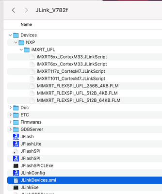

To MCUBootUtility, form SDKv2.10.0, Reset_Handler() is used as entry point, not vector table. So, it seems the 0x60002035 is correct.(base on your image) MCUBootUtility will replace your FDCB by default. If it can read/write flash already, the auto generated FDCB should be correct.
To jlink flash algorithm, I think the better way is to follow Jay's suggestion, using RT-UFL can make it simple. You needn't make a new .cfx. The reference link shows how to make a .cfx for RT1052. RT1020 can't use it. At least you should modify the pin config. You can start from the iMXRT1050_QSPI.zip.

Thanks Jing.  Is there any additional documentation on RT-UFL?
For example, what operating systems are supported and how to build and run the application?

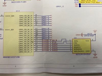

Below is the schematic of the processor / memory connection as well as the pin definitions.
Screen Shot 2023-01-04 at 9.28.44 AM.pngScreen Shot 2023-01-04 at 9.28.44 AM.png
Is it possible the QE bit on the flash needs to be enabled?  If so, what is the easiest way to do this?

Hi @mrecoskie ,
RT-UFL support Keil/IAR/MCUXpresso. There is only Chinese document.
https://www.cnblogs.com/henjay724/p/13951686.html
https://www.cnblogs.com/henjay724/p/15430619.html
https://www.cnblogs.com/henjay724/p/14942574.html

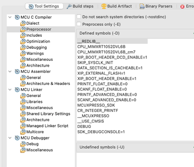

The application is the hello_world sample with four modifications.
1) I've tried both the 'MIMXRT_1050_SFDP_QSPI.cfx' and 'MIMXRT_1050_IS25WP064A.cfx' Driver settings under the Project Settings > Memory.
2) I've set the preprocessor defines 'XIP_BOOT_HEADER_ENABLE=1', 'XIP_EXTERNAL_FLASH=1' and 'XIP_BOOT_HEADER_DCD_ENABLE=1'.
3) I've defined a 'flexspi_nor_config_t qspiflash_config' in the 'evkbimxrt1050_flexspi_nor_config.c' as found above in this thread.

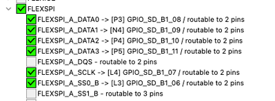

4) I've made pin route definitions for the FlexSPIA bus, UART, JTAG and SRC pins.
These are the only changes.  Please find attached.

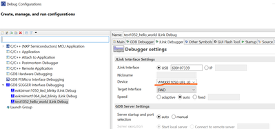

jingpan
Hi @mrecoskie ,
Segger JLINK is very special. It doesn't use RT1050_SFDP_QSPI.cfx or RT1050_EVK_IS25WP064.cfx assigned by MCUXpresso. This is way we suggest you to use RT-UFL.
After you install RT-UFL, you should assign program algorithm here.
I tested your project, it can debug in mcuxpresso.
Jing

jingpan
Hi @mrecoskie ,
Just download the package and copy Device folder and JLINKDevices.xml to JLink install folder. That's all. My jlink driver is v7.82c.
Jing
11,588件の閲覧回数
mrecoskie
My jlink driver is v7.82f.  I copied the ‘Devices’ folder and JLinkDevices.xml to the Jlink install folder except nothing unique comes up under 'Device' to select in the MCUXpresso Debug Configurations.  What  should I expect here?
Mark
Screen Shot 2023-01-10 at 12.34.50 PM.pngScreen Shot 2023-01-10 at 12.34.50 PM.png
Screen Shot 2023-01-10 at 12.45.40 PM.pngScreen Shot 2023-01-10 at 12.45.40 PM.png
11,576件の閲覧回数
jingpan
Type "MIMXRT1050_UFL_L0" here.
11,569件の閲覧回数
