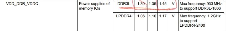

    Our design platform :IMX8QX : MIMX8QX6AVLFZAC  +  16bit DDR3L/DDR3.
    IMX8QX support 32bit+8bit DDR3L. But we need only 1pcs 16bit DDR3L.
1. Can we design with only 1 pcs 16bit DDR3L(lower 16 bit), and leave 16~40bit DQ floating?
2. Whether IMX8QX support DDR3 voltage level: 1.5V?

Hi @alexjiang
Q1: Can we design with only 1 pcs 16bit DDR3L(lower 16-bit), and leave 16~40bit DQ floating?
Ans: Yes, You can use 16bit addressing and leave 16~40bit DQ as a float. Because MMDC is a multi-mode DDR controller that supports DDR3/DDR3L at 16bit mode.

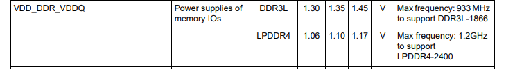

Q2:Whether IMX8QX support DDR3 voltage level: 1.5V?
Ans: Yes, Refer to datasheet page number 13.Screenshot 2023-01-16 9.53.27 AM.png

alexjiang
 @KalaimaniArumugamdev
the picture show IMX8QX VDD/VDDQ  I/O  support DDR3L:1.35V, MAX  DDR3L voltage :1.45V.
and IMX8QX datasheet does not show whether support  DDR3: 1.5V, 1.425~1.57V(DDR3 voltage range),
only show DDR PHY supplies  VDD_DDR_VDDQ max:1.75V.  Does it means that we can use DDR3 IC and supply 1.5V voltage to VDD/VDDQ?
513 Views
riteshmpatel
Hi @alexjiang,
i.MX8QXP supports DDR3L and LPDDR4 only.
Thanks & Regards,
Ritesh M Patel
