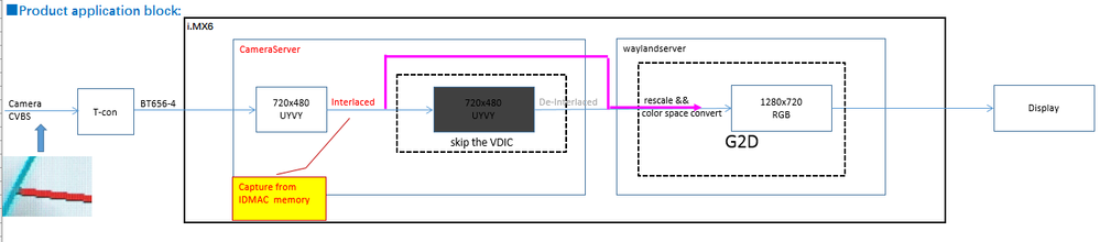

■The pathway of Video System Block is below.
 PVM ECU------>CVBS------>T-con----->BT656-4------->i.MX6---->CSI of IPU

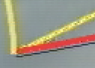

■The CVBS signal is like below.
■For setting the CSI only mode of IPU, and capture of  IDMAC memory,the guide line is not correct.

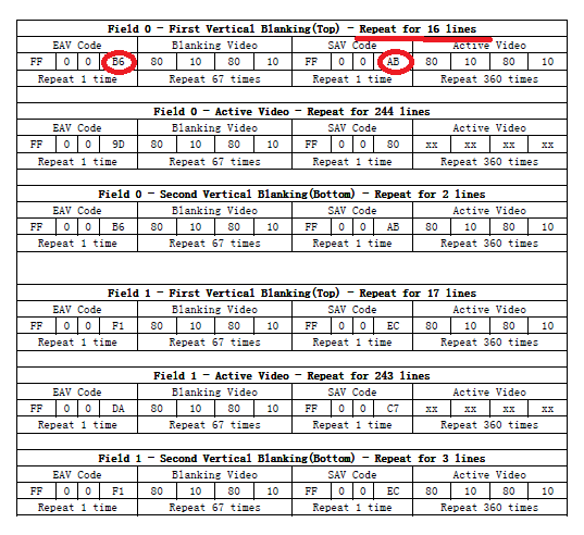

About the IPU2_CSI1_CCIR_CODE_2,I only change the V setting of below.
CSI1_STRT_FLD0_BLNK_1ST: from 1 to 0
CSI1_END_FLD0_BLNK_1ST: from 1 to 0
Although the guide line is correct,but I don't understand the operating principle of this change.

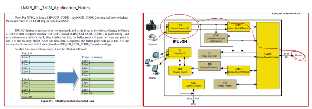

Hi igor,
I have read this file and the setting is according to this file.
But I can't understand the meaning of only change the Vbit setting as below.
CSI1_STRT_FLD0_BLNK_1ST: Vbit :from 1 to 0
CSI1_END_FLD0_BLNK_1ST: Vbit  from 1 to 0
From the status, only one line blanking is changed.
But according to below table, if change the EAV and SAV of the first blanking that will be changed for 16 lines not one line.

igorpadykov
Hi LU
for various ccir settings one can look at TVIN Application Notes
iMX6 IPU TVIN Application Notes
igor
