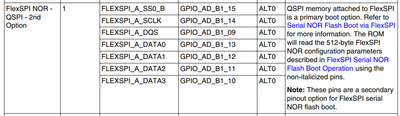

    If you want to use the secondary boot, you don't need to configure the IOMUXC by yourself, ROM will help you do it.
  When you use the secondary boot:
burn eFuse 0x450 or  BOOT_CFG pin, set FLASH_TYPE[2:0] = 111 - QSPI device supports 3B read by default on secondary pinmux option
  So, when you BOOT, it will read the BOOT_CFG pin configuration or the eFuse, when it matches the secondary pinmux option, the ROM code will help you configure the IOMUXC directly.

GPIO_AD_B1_15 doesn't need to use the daisy for ALT0.

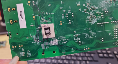

we soldered the Flexspi secondary port A to an external 3.3V flash (see picture below)
  1. FlexSPI_CLK- from R228 (on IMXRT1050-EVKB) to  pin 6 on Flash
  2. FlexSPI_SS0- from R229 (on IMXRT1050-EVKB) to  pin 1 on Flash
  3. FlexSPI_D0_A- from R227 (on IMXRT1050-EVKB) to  pin 5 on Flash
  4. FlexSPI_D1_A- from R226 (on IMXRT1050-EVKB) to  pin 2 on Flash
  5. FlexSPI_D2_A- from R225 (on IMXRT1050-EVKB) to  pin 3 on Flash
  6. FlexSPI_D3_A- from R224 (on IMXRT1050-EVKB) to  pin 7 on Flash
  7. FLASH_VCC- from J13.2 (on IMXRT1050-EVKB) to pin 8 on Flash
  8. GND from J11.2 (on IMXRT1050-EVKB) to pin 4 on Flash

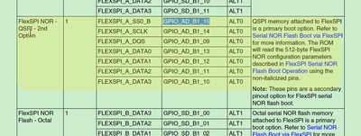

  So you connect the flash chip here:
  But, your mentioned point is not enough, as you know, the related pin is also connect to other component,  to be honesty, I think, your connection maybe have issues, as the wire connection don't like the PCB layout, which is stable.
  Anyway, just try to remove the find issues.
1.FLEXSPI_A_SS0_B: GPIO_AD_B1_15, ALT0, remove R98
2.FLEXSPI_A_SCLK GPIO_AD_B1_14 ALT0, remove R99
3.FLEXSPI_A_DQS GPIO_AD_B1_09 ALT0, remove R223,R102
4.FLEXSPI_A_DATA0 GPIO_AD_B1_13 ALT0, remove R101
5.FLEXSPI_A_DATA1 GPIO_AD_B1_12 ALT0,remove 100
6.FLEXSPI_A_DATA2 GPIO_AD_B1_11 ALT0, don't connect J23
7.FLEXSPI_A_DATA3 GPIO_AD_B1_10 ALT0, don't connect J23

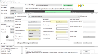

About the testing, you can use the MCUBootUtility, configuration like this:
quad mode setting, you need to check your used flash datasheet.
Check whether you can find the flash or not?

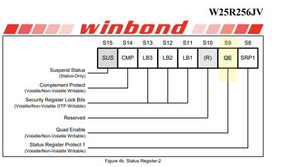

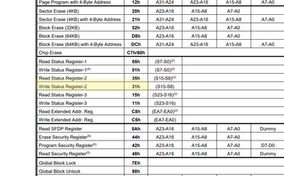

  I checked your datasheet, your QE bit is S2[1], command is 0x31.
So, please check you use the correct QE bit postion and command, test it again.
