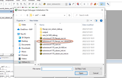

I want to change an app for the IMXRT1176-EVK from using the QuadSPI flash XIP to using the Octal SPI flash XIP (as this is what we will use on our product board). The app currently contains a pre generated dcd.c file for the QuadSPI from the SDK. Where can I get the DCD configuration for the Octal device? Is there a suitable .mex file for the Device Configuration app that is setup for the Octal? All SDK examples appear to be for the Quad.

I am using the Keil MDK for development with a ULINK Pro. So I am not aware of .scp and .cfx files.
Is there any documentation that describes the DCD in more detail?
The Board Support Package that is loaded into MDK has 2 SDK drivers - 'evkmimxrt1170' and 'xip_board', plus an SDK Project Template that has 2 options 'MIMXRT1176' and 'evkmimxrt1176'. Is there any documentation that explains what these are and how to use them? It loads a file 'evkmimxrt1170_flexspi_nor_config.c' into the project which does seem to define the flash type - I assume this needs to be changed to use Octal flash?

kerryzhou
Hi @VicKrawciw ,
   Which debugger you are using now?
   If you are using the on board CMSIS DAP, you still can use the original one, and the sdram is defined in the .scp file. the .cfx determines which flash you are using.
To the dcd, it is totally use the original one, as it is the same for the QSPI flash and octal flash, you don't need to change it.
  After you change to the Octal flash, I suggest you use the MCUbootUtility tool  to download code in serial download mode at first, just to check whether your hardware is working or not.
