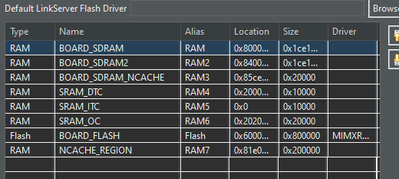

Hi everybody, hope this email finds you well, I would appreciate some help about a proyect that I'm doing, I'm developing a custom board based on IMXRT1020 EVK, with the difference that I'm using two SDRAM chips to add more memory for future software developments, these SDRAM are connected to two independent 512Mbit sectors of the SEMC using two CS:

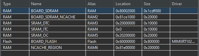

Using one SDRAM (SDRAM0 connected to CS0) and MCUBootutility I can download an image to the uSD with a DCD file and everithing works fine just with one SDRAM:
These are the MCU Settings to use only one SDRAM:
Problem: When I try to use the other SDRAM (CS1) putting the heap and stack there (those are in the BOARD_SDRAM_NCACHE region), it doesn't work any more:
These are the settings to use two SDRAM:
I've attahced the DCD file that works fine with one SDRAM but not for two, this DCD file is modified to send IP commands to the second SDRAM (starting with 84000000 address).

Hi Jingpan, many thanks for your answer, I didn't try what you say, booting from NOR flash I can initialize from code and use both SDRAM, but not at the same time.
First I initialize, by code, SDRAM0 on CS0, then I do a test first fillin SDRAM0 and then reading it to compare, after that I do the same thing with the other SDRAM1 on CS1, the result is good, but if I try filling the SDRAM0 on CS0 again, the reading loose many bytes, unless I initialize SDRAM0 again.
So seems to be that I'm not initializing the SEMC correctly to use both sectors, CS0 and CS1.
I'm trying but I can´t find the correct way to do it.
About the DCD file, I have a file (attached previously) that I'm using to boot from SDRAM0 added using MCUbootutility, of course it doens't work to add SDRAM1 to my memory map.
