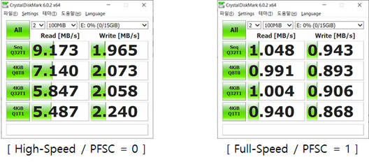

Eric_bj_Kang
Hi Igor,
Thanks for your response.
I confirmed the operation to change the speed from High to Full.
For this, I just set the PFSC bit as "1".
For Detailed, refer to the below contents.
> Test Board : i.MXRT1050-EVK
> Test Project : evkbimxrt1050_dev_msc_sdcard_lite_bm
> Modified Register :
   - USB_nPORTSC1 register / PFSC bit
   - 0, High-Speed (default) / 1, Full-Speed
> Test Result, for High-/Full-Speed
   - i.MXRT_1050_02-5.3_USB.Full.Speed.Test_Test.Result.pngi.MXRT_1050_02-5.3_USB.Full.Speed.Test_Test.Result.png
> Modified Source / Contents
   - source/disk_sdcard.c
int main(void)
   USB_DeviceApplicationInit();
   // check USB1->PORTSC1 value
   usb_echo("USB_PORTSC1(0x402E0184) / PSPD, bit.27-26 = 0x%0X \r\n", (uint32_t)(USB1->PORTSC1)); // 0x1C00.0004
   // force USB Port, as Full-Speed - Eric
   USB1->PORTSC1 |= USB_PORTSC1_PFSC(1); // 0 - High-Speed(default) / 1 - Full-Speed
   usb_echo("USB_PORTSC1(0x402E0184) / PSPD, bit.27-26 = 0x%0X \r\n", (uint32_t)(USB1->PORTSC1)); // 0x1D00.0004
   while (1)
Eric.
