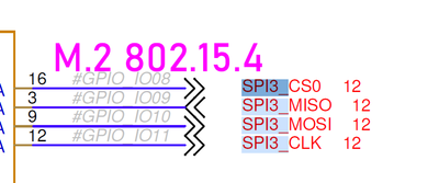

It seems to me that I need to use the SPI_3 interface. But I'm not even sure that that is brought out to a header on the EVK? I saw this in the EVK board design files and thought it might suggest that interface is the one to use?

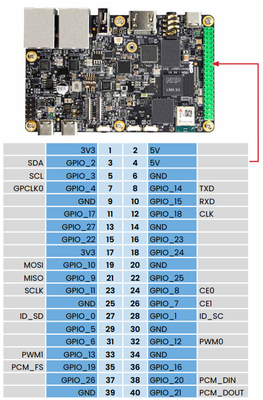

You can quickly see the interfaces in the next diagram from FRDM-i.MX93, RPi connector shares the same GPIOs with EVK.
Nevertheless, for full gpio functions and gpio list I recommend to use config tools, you can load EVK config and see the available pins, in this case, you can use LPSPI3.
