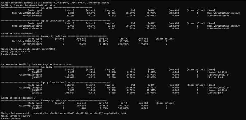

Further update,
I'm trying with Running benchmark applications.
root@imx8qxpmek:/usr/bin/tensorflow-lite-2.2.0/examples# ./benchmark_model --graph=efficientnet_lite0_int8_2.tflite --use_nnapi=true --enable_op_profiling=true
From the logs, computation graph was executed on CPU only Not used GPU Hardware.
GPU info:

13,235 Views
joanxie
as the gpu performance data I sent to you, which is from the gpu test team, you can refer to that
13,222 Views
darsh_dev
Contributor V
@joanxie You have shared the GPU performance result is not matched with the IMXMLUG guide. Which result I can consider the benchmark for the IMX8QXP and IMX8Mquad?
I also checked with IMX8MQuad platform. Observed the weired behaviour
With CPU average time is 52ms and with GPU "-a 1" option average time is 102ms
root@imx8mqevk:/usr/bin/tensorflow-lite-2.2.0/examples# ./label_image -m mobilenet_v1_1.0_224_quant.tflite -i grace_hopper.bmp -l labels.txt
Loaded model mobilenet_v1_1.0_224_quant.tflite
resolved reporter
invoked
average time: 52.605 ms
0.780392: 653 military uniform
0.105882: 907 Windsor tie
0.0156863: 458 bow tie
0.0117647: 466 bulletproof vest
0.00784314: 835 suit
root@imx8mqevk:/usr/bin/tensorflow-lite-2.2.0/examples# ./label_image -m mobilenet_v1_1.0_224_quant.tflite -i grace_hopper.bmp -l labels.txt -a 1
resolved reporter
INFO: Created TensorFlow Lite delegate for NNAPI.
Applied NNAPI delegate.
W [query_hardware_caps:66]Unsupported evis version
invoked
average time: 104.467 ms
0.784314: 653 military uniform
0.00784314: 466 bulletproof vest
0.00392157: 835 suit
12,835 Views
lmurillo
@darsh_dev were you able to figure out what could be the problem here? I am having exactly the same weird behavior in the IMX8Mquad.
@joanxie any suggestions?
Thanks!
13,142 Views
joanxie
yes, you can consider the data I sent to you as benchmark of  imx8qxp, which is from local testing team, it seems this demo has some issues, the testing team doesn't use this command
