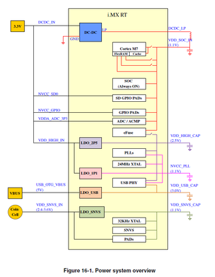

I using a MIMXRT1015-EVK board.
In i.MX.RT1015, what is the power source of SJC(Secure JTAG Controller) component (especially, response comparison such as the following figure)?
(ex. DCDC_IN, SOC_IN, VDD_SNVS_IN, ...)

SJC is on SOC so the power source is VDD_SOC_IN:
If you have more questions do not hesitate to ask me.
